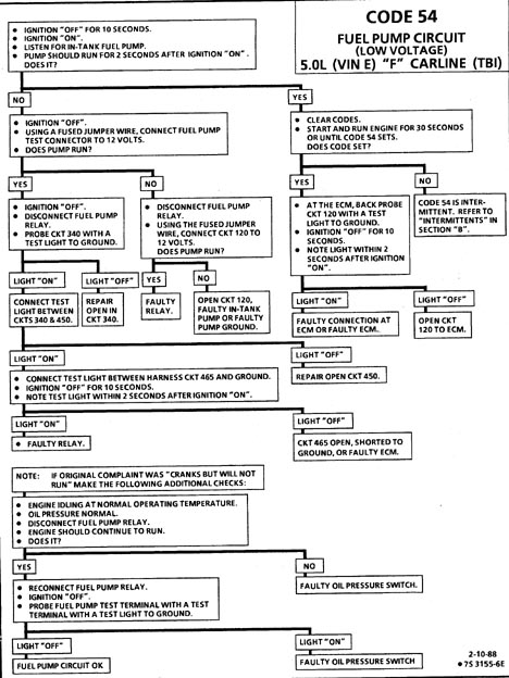

as per code 54 flowchart: 2 second runtime- yes, cleared code, attempted to start several times, checked for codes- ecu clean so "go to section B intermittents" not included in flowchart. does anyone know where this excerpt is from? It's got a new fuel filter and as I say the fuel pump does it's 2 second cycle each time so I would think it's not clogged unless the two second runtime with a clogged filter would just dump the overflow caused by a restriction back in the tank?

flowchart is from trickster post here
