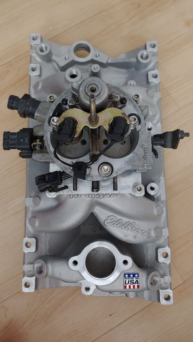

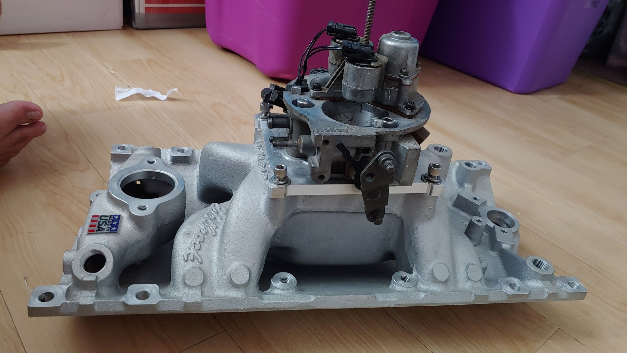

I know this is an old thread, but I do have one question:
What PROM chip specs did you used with this setup and what service/website you used for it?
I'm doing a very similar setup, but with a Holley 670 CFM throttle body.
Thank you!

Kinda depends on WHICH Holley 670 throttle body; and what other engine modifications have been installed.
Holley made a series of "stock replacement" "670" throttle body assemblies that supposedly drop right on a stock engine with no "tuning" required. There were multiple part numbers, specific to various standard engine combinations.
But if you're using a non-stock-replacement throttle body on a modified engine, you'll need computer tuning. I can't help with that.

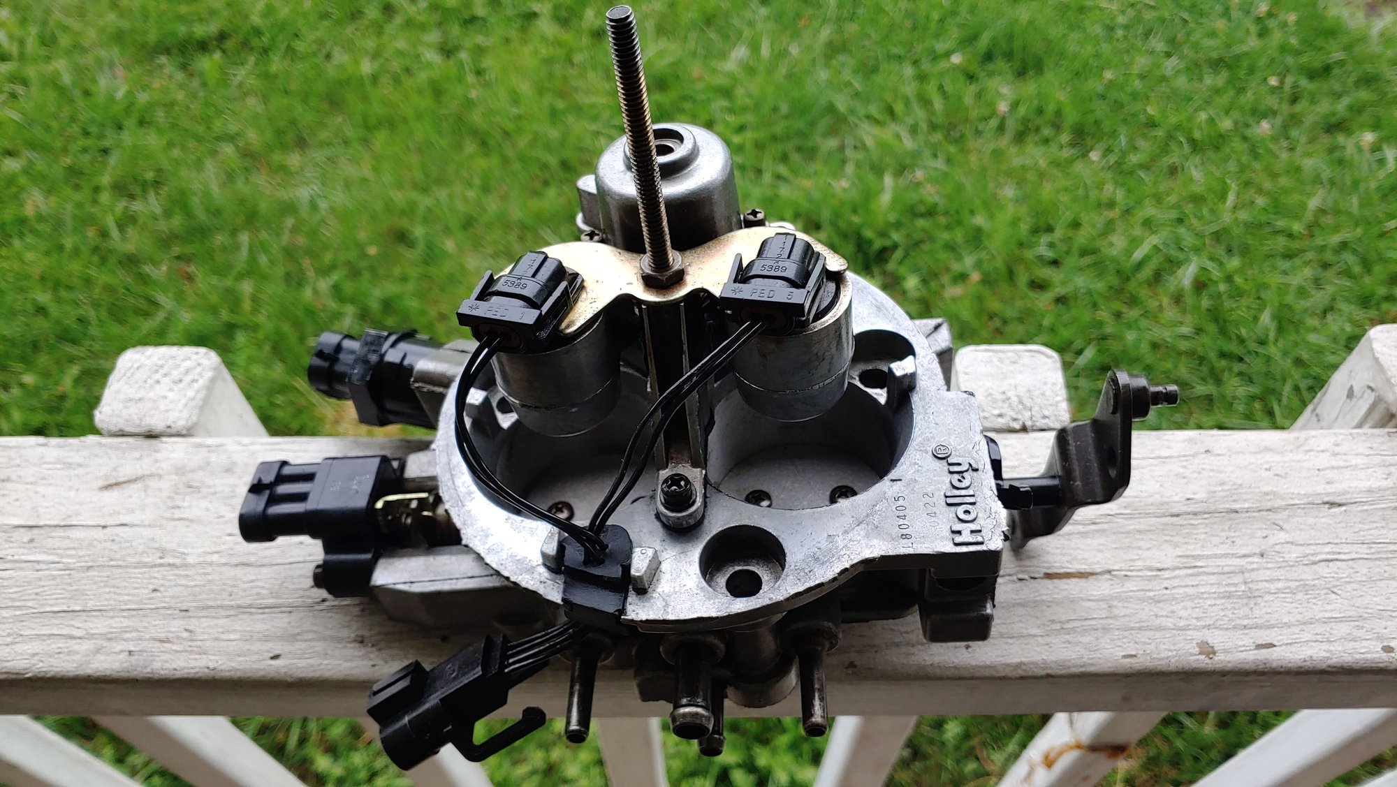

There are 2 things to running that Holley TBI. First is to ditch the trouble prone Holley injector pod and retrofit a stock GM one in its place. 2nd is move the MAP vacuum line from the rear port to the manifold vacuum port up front. The casting is poorly designed where the MAP fitting sits as it sits directly in the IAC passageway. On cold start when the IAC is open it gives the MAP a low vacuum signal and often sets a code 34 high map code and will run so rich it throws black smoke.

I'll be using a pair of 059 Vortec heads, a 94 Z28 LT1 cam and already have a 3 inch exhaust system with headers. Will get me a set of Comp Cam 1.6 rockers and a set of LS beehive springs.

Holley has two kinds of injectors in their throttle bodies, depending on when they were made.
I knew the first kind was troublesome. I thought the second-design worked well. The first design has a rubber cover on top of the injector, looks aerodynamic. The second (improved) design is more plain; just the molded-plastic connector as shown in the photos already posted.
First design:
Are you saying that the second-design injectors are still a problem, or is there something in the injector pod itself that's an issue?
I have one of these Holley "stock replacement" throttle bodies; but I've never installed it. On the "list of things to do" "someday".

Neither design works all that well from Holley. The GM injectors are easier to tune since the injector data is already correct for them. The GM injectors are also more obtainable as are the regulator rebuild parts. 1,000 miles from home I want something I can find quickly off the shelf.
NONE of my EFI setups have one off failure parts with the exception of the 48 lb/hr spider on my Express van. I have not had a MFI injector failure on a Vortec though, but have had regulator trouble from it leaking. AUS spider uses a stock fuel meter rebuild kit and a stock GM regulator.

It is amazing that Holley has done everything they could to give TBI a bad name. First the lousy injectors used on the first design. Then the lousy cheap body castings. Now the wrong MAP pickup location.
I've even seen Holley units on trucks in the JY and just walked on by. Wasn't worth pulling them off seeing the early style injectors.
