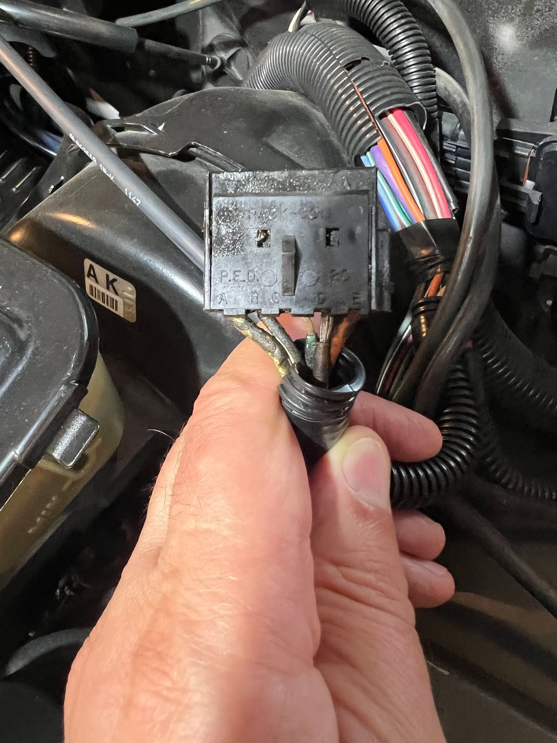

I had the same problem. The wires and contacts on the fuel pump relay connector were fouled up with grease and dirt. It also looked like one of them pulled out of the connector a little bit. I cleaned them and pushed them all back into the connector very firmly and it started right up.
