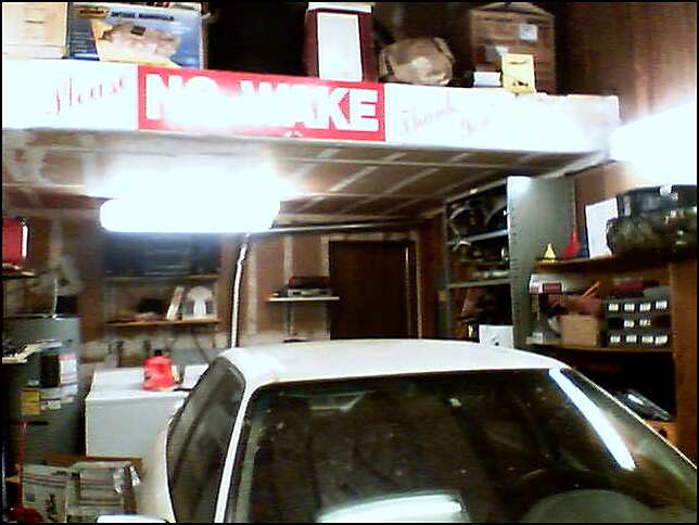

Do you need EGR? That really limits the options. Or do you just need the apperance of EGR.
And for the bumper and stuff, no worries, If you happen to spot one in a junk yard, or used for a good deal, just let me know. I am in no hurry, this is how my car is sitting right now
http://cascadecrew.org/John/turboswap/install3.jpg
(I am putting in a 10v turbo now, it had a N/A 20v motor. But I have the turbo manifold, and 20v head still, so if I get ahold of some S2 or RS2 intake parts, I can go that route at some point in the future)
Hey Dewey, for a second there when I saw that link I thought you were doing a turbo swap on your Camaro haha. Anything new going on the Camaro?

Nothing new motorwise right now, putting new brakes on soon, hopefully a 9" this fall, then I need save up for a T56. After those things are done, then the next project will start. Gotta get it ready for 500-600 HP.
Haha.............John you have a bigger mess than I do........LOL

DM,
That is not a mess, that is a FUNCTIONING garage. , that was also at my old place. The new garage is slightly more organized.
http://cascadecrew.org/John/lights3.jpg

No way.....LOL.....
I as we speak am moving my old 3.08 rear and oldladys 350 around just to paint my garage..............
