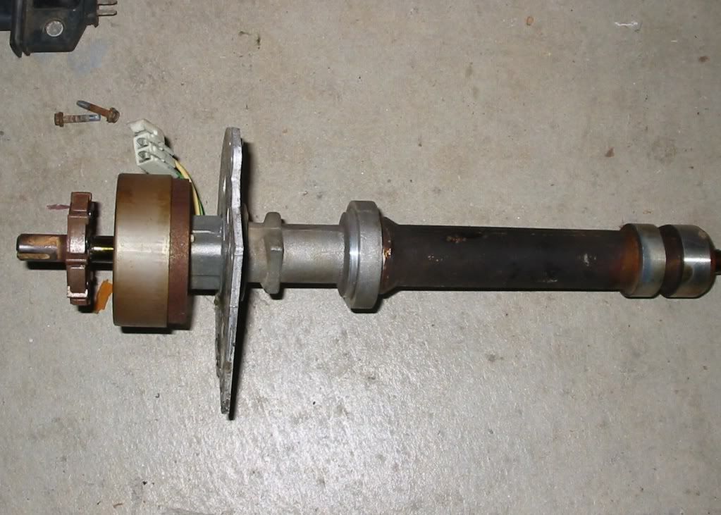

Before yanking dizzy again perform coil resistance check as outlined in the earlier post.
Replacing reluctor (aka pick-up) coil requires dizzy removal and partial disassembly.
Take out dowel pin from cam gear (not shown) and slide shaft out of the dizzy body. Note that your dizzy may be of a different construction, but basically the same.

Gently pry retaining ring of the shaft. Replacement reluctor kit may have a new retaining ring - take a look if it does when picking it up from parts house.
