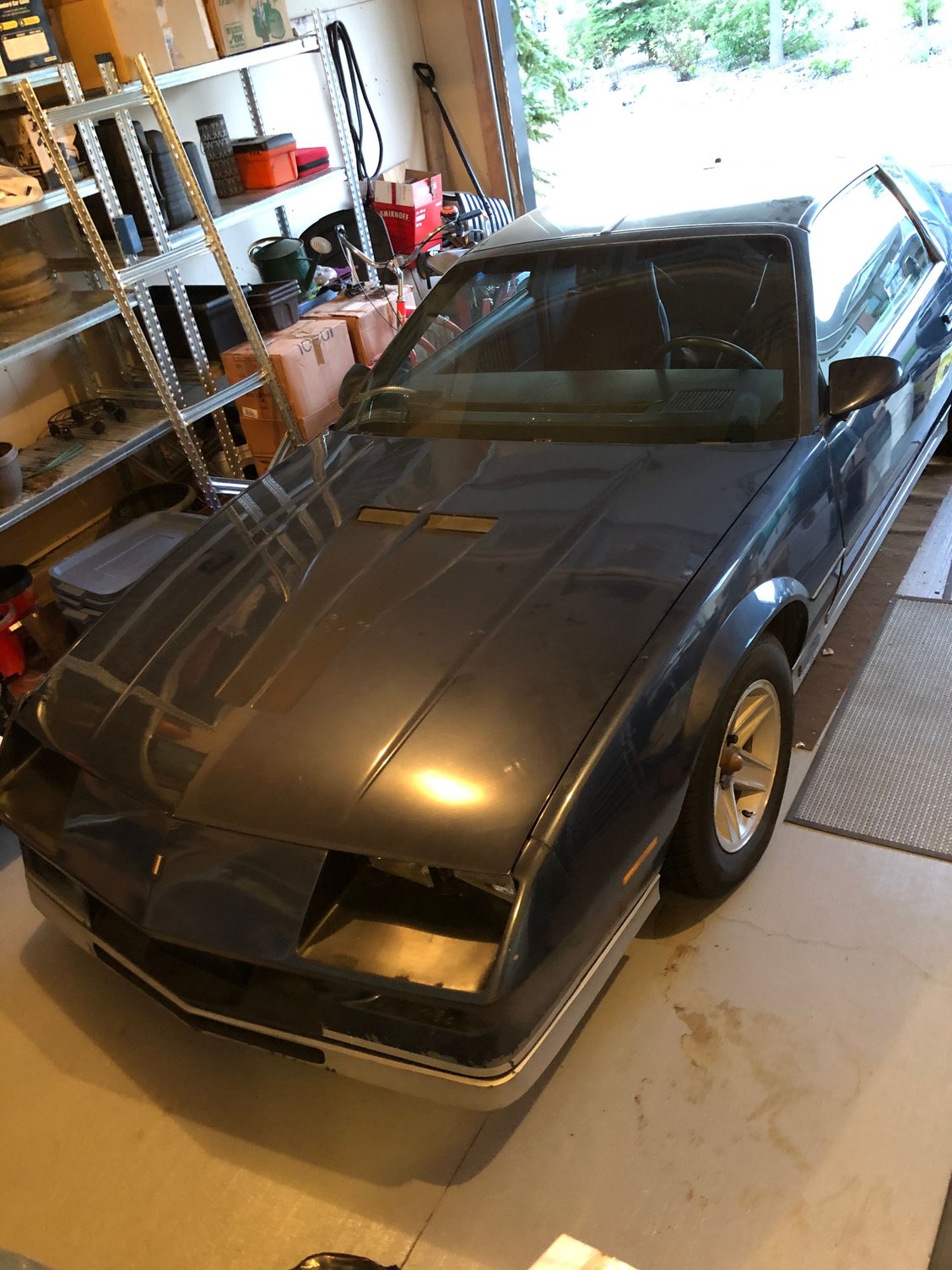

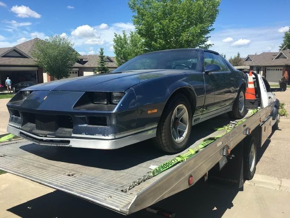

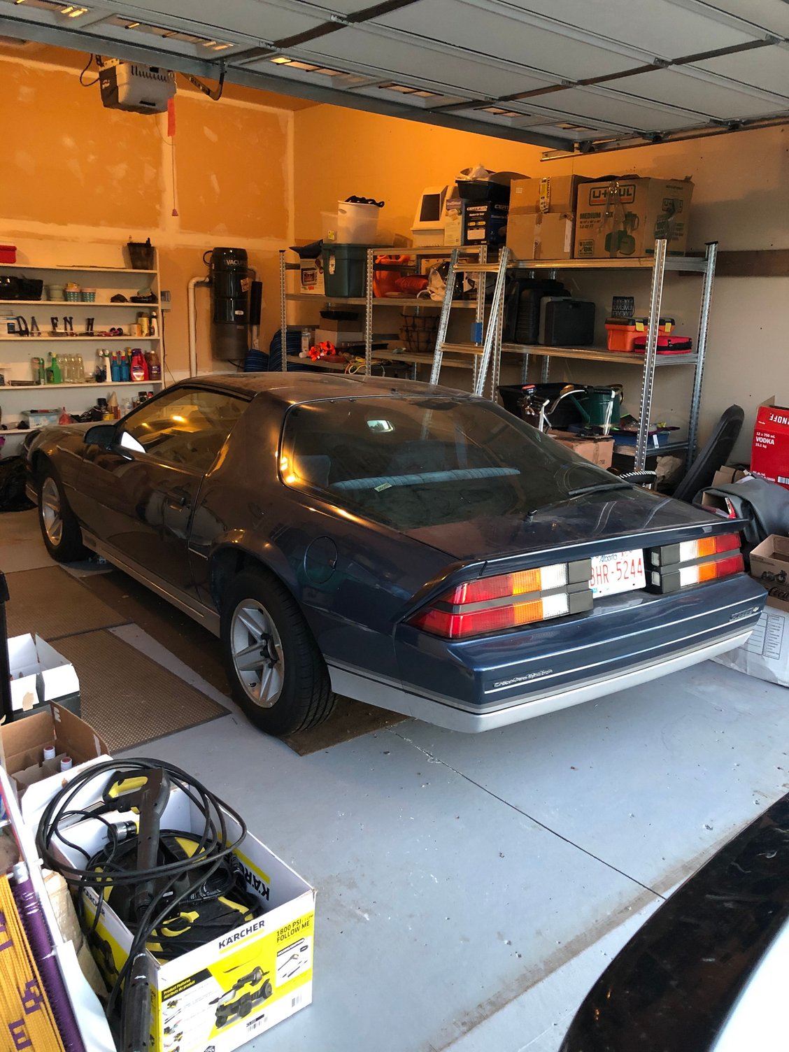

New here.
Hey guys I recently inherited an 83 Z28 with crossfire injection. The car has been sitting in my grandfather’s garage since 2004. As such the fuel pump is shot. I got the car hauled to a reputable mechanic who has experience with the style of car. ( he had an 82) he pulled the fuel tank and said its shot and the sending unit is to as well as the pick up tubes and screen. I can’t seem to find parts anywhere for this car and really don’t want to give up on it as it is great shape other wise and only has about 62 thousand miles. Any help would be awesome. TIA!!!

Re: crossfire injection
Install one from a tpi car
ok thanks! I’m going to David T’s firebirds and Camaros today to try and match up some parts.
