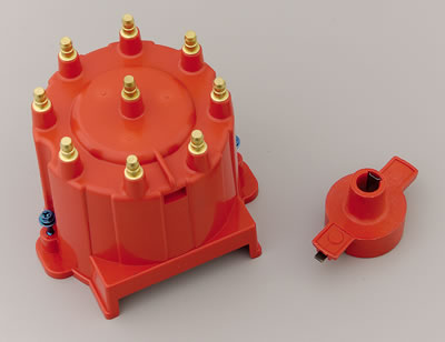

Re: lost firing order
See that line on the top of the dizzy that is centered with the coil post. To the left of that line going clockwise is 21843657.
If using a stock cap there will be two lines, one facing the driver door about (as shown above) and the other 45* to the strut tower. Let me know if you need a small video or something to make it easier.
