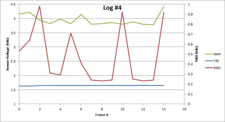

OK I have downloaded all your data files and had a chance to look through the data. The older tool that you have is very sneaky - it fills blocks of 10 identical readings into a data file. There are no time stamps (or engine run time) to go by. I had to import this this data into excel and do some massaging to get something meaningful.
1) IAC - I do not believe that this tool is reporting it correctly. The counts are too high. Pull you EVO and see what it reports at idle - stock engine should be around 10 to 30 counts. Otherwise perform IAC reset. Procedure is posted in the technical articles.
2) MAP voltage is jumping a lot under steady state driving (Log #4). TPS is flat 1.63 to 1.65 while MAP voltage is bouncing between 3.78 and 4.43 Vdc, which is a lot! That should not be happening under steady state throttle on a flat road (IAC is at 128, but I suspect this is incorrectly reported by this tool). All other sensors are rock steady:
CTS 151 to 156F
IAT 68 to 79
O2 is bouncing in a CL (0.24 to 0.92) which is OK
RPM show jumps, but I suspect it is due to MAP providing ECM with inconsistent voltage.
Conclusion(s) - reset IAC, MAP sensor either acting up or actually reporting true values. Bad MAP???? or a vacuum leak in the hose - TB vacuum port.
//RF

Wow, you are definitely the guy to talk to! You know your stuff.
When I put in the new distributor, I knocked off the vac hose to the MAP sensor, it left a code, I didn't see I had knocked it off, and went to get a new MAP sensor. As I was installing it, I saw I knocked it off. But I decided to try the new MAP anyway. It didn't change how it ran at all. So I left the old one installed. Unless I got a bad sensor from NAPA.
When I pulled the logs, I tried to stay, for the most part, in the worst running section. At those RPM's the engine was in a constant stumble. Waa Waa Waa Waa Waa waa waa. Very odd. That is why I suspect the high map readings?
I will double check the IAC readings and go through the reset.
Thanks so much for the help so far.
