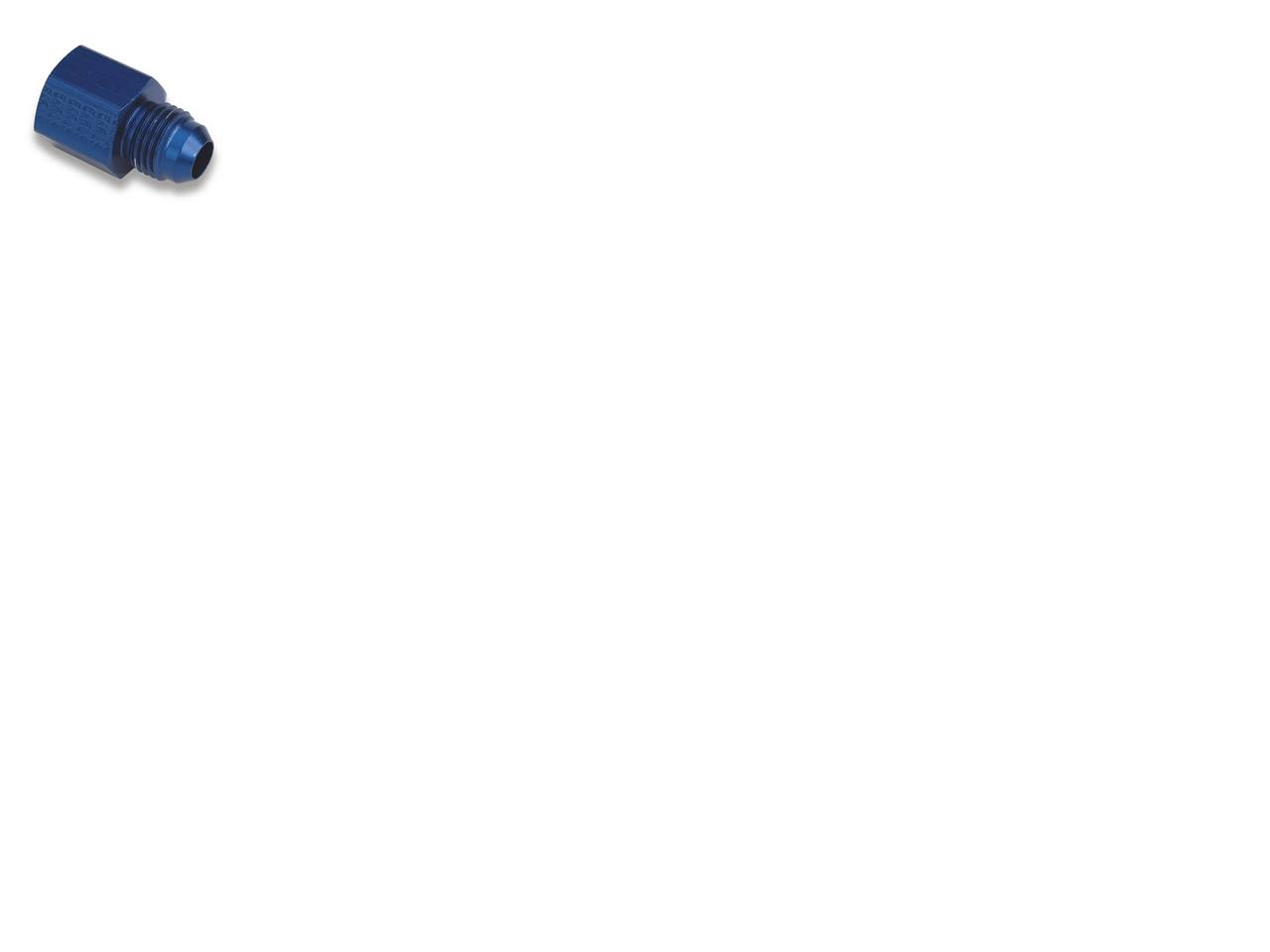

If I am not mistaken I think a lot of guys ditch the female rubber hoses - then go from the cars frame hardline male end to these female AN6 adapters ...they are different sizes at 14 mm X 1.5 return and 16 mm X 1.5 supply not 3/8.... read about the fuel lines here at this URL http://z28boy.cz28.com/mods-fuellines.htm ..there are a lot of ways to do it -barbs etc I just like AN fittings ...I have included the p/n's and prices below for you ...I just went through this on my TBI to carb swap but haven't pressurized the system yet to check for leaks...hopefully it all works..... NOTE my 4309 regulator then has 3/8 N.P.T. inlet / outlets on it .
EAR-9894DBHERL AN to Metric adapter 14mm X 1.5 $8.97
http://www.summitracing.com/parts/ear-9894dbherl
EAR-9894DBJERL AN to Metric 16mm X 1.5 $8.97
http://www.summitracing.com/parts/ea...jerl/overview/
https://www.thirdgen.org/forums/carb...s-305-tbi.html
