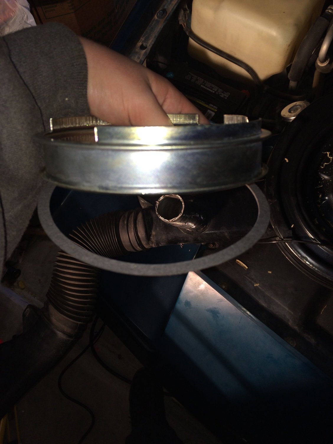

Does this round gasket go under the air cleaner or under the round cage on TB cage?
I was convinced it went under the round cage (first picture) but then I noticed the old crusty gasket under the air cleaner that's the same size. The instructions don't say.

Pix?

Re: Does this round gasket go under the air cleaner or under the round cage on TB cag
Under the air cleaner
Originally Posted by TTOP350
Pix?
Just added them
It is supposed to go directly on top of the throttle body.
Need two gaskets, one on top of the TBI unit and one on top of the spacer ring (cage).
RBob.
What does the one that goes directly on the TB look like like?
So below the spacer ring?
Both are the same gasket.
RBob.
Ok. That's the second gasket ACDelco didn't put in. This is getting on my nerves! Thank you.
