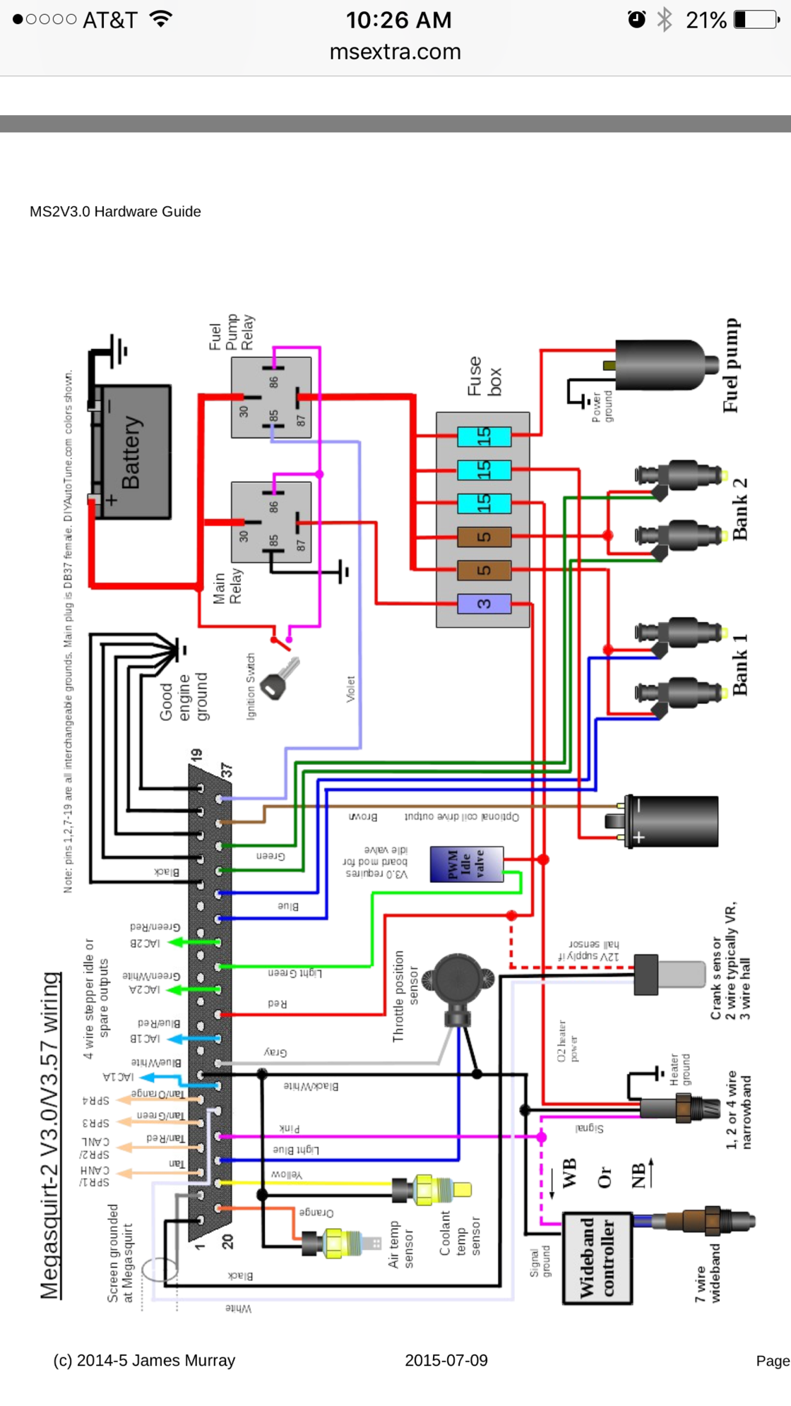

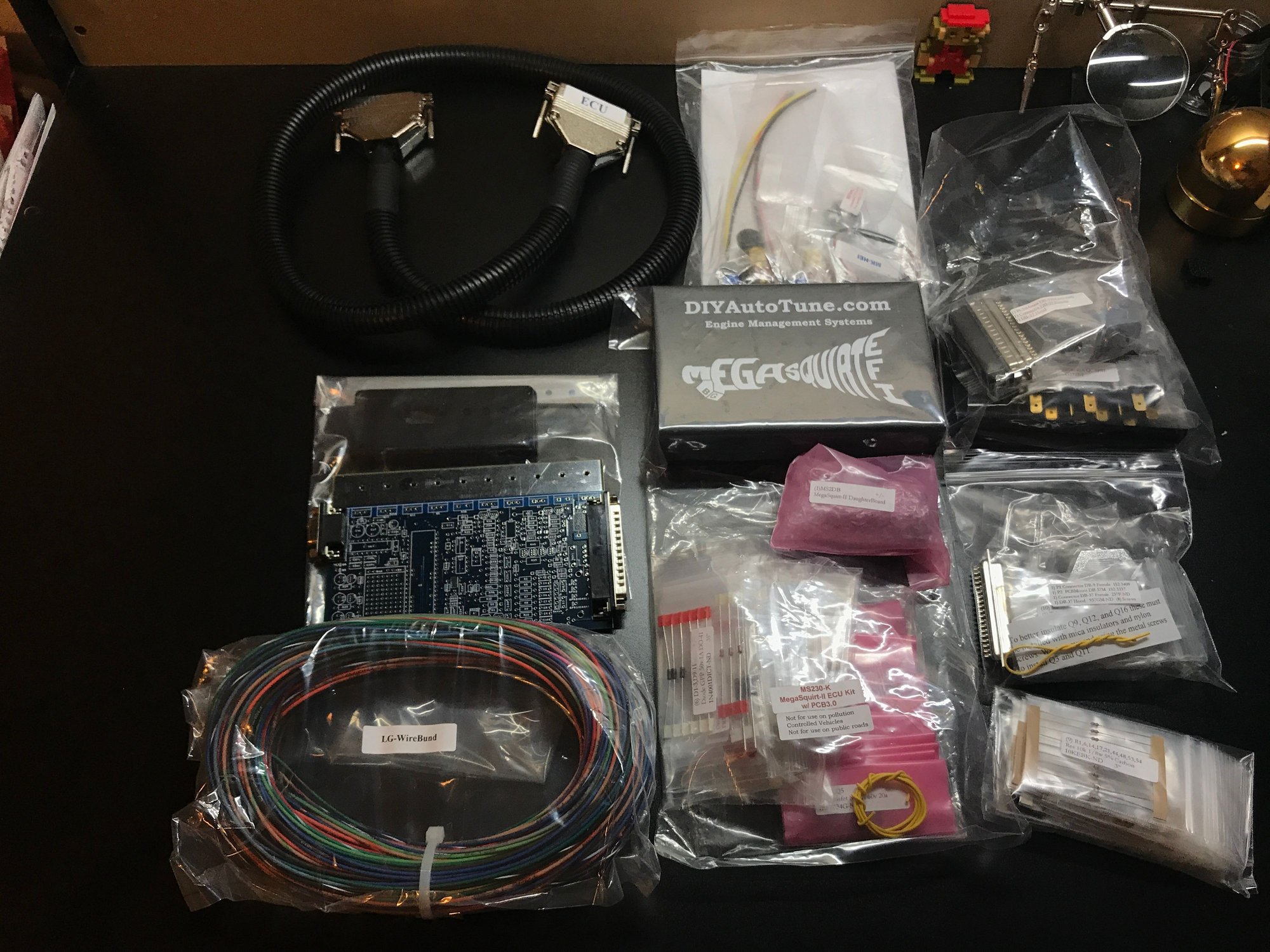

Below is picture of the Megasquirt computer I'm assembling for this setup. Just to throw this off topic a bit. That's Super Mario in the back as well lol...

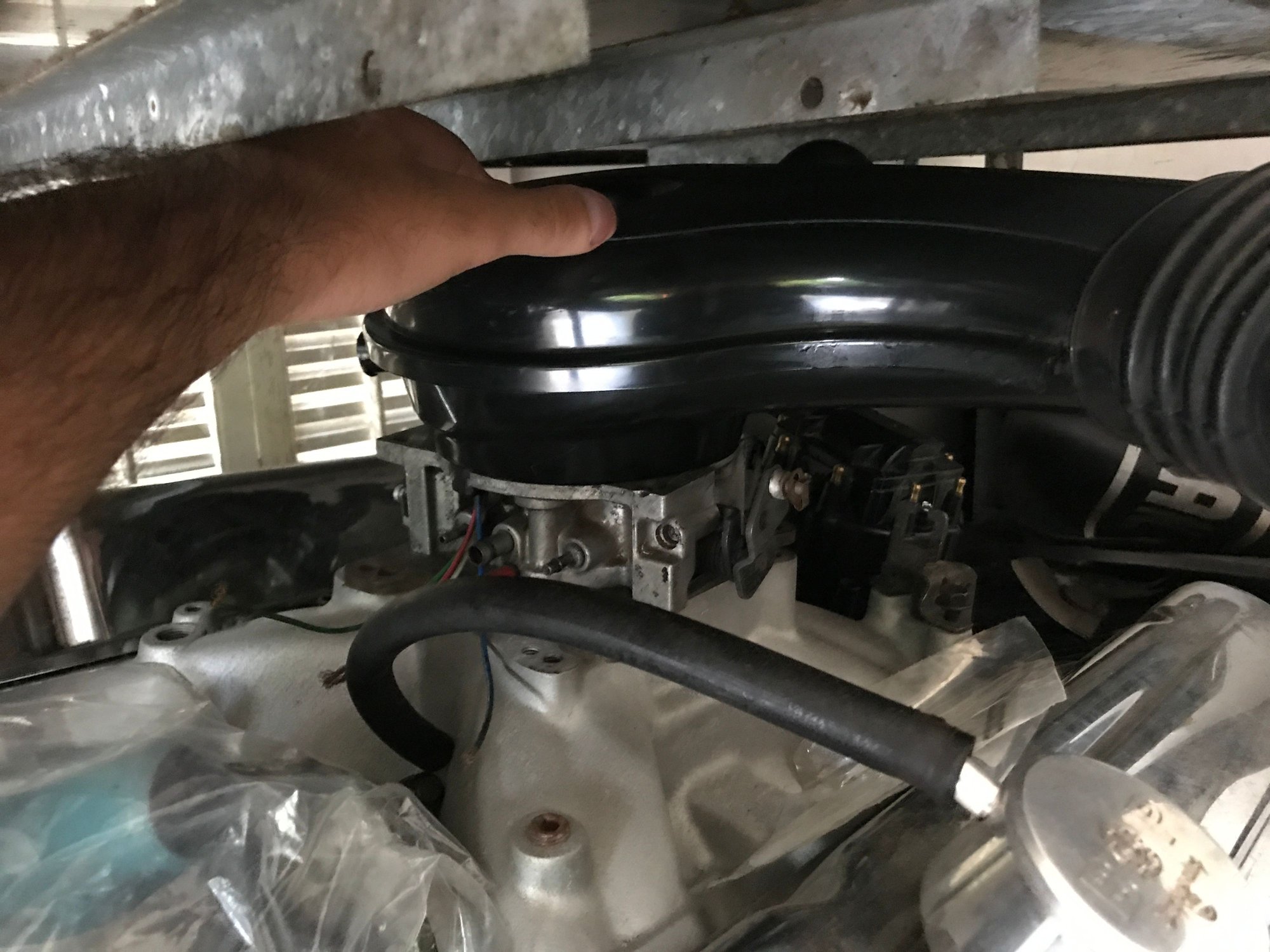

This setup is going in my '79 Trans Am 400 4spd. I bought the diyautotune carb-to-efi kit as previously pictured in the thread. It pretty much comes with everything to wire up the computer and efi related parts. Even has a relay/fuse board so everything goes in one spot. Attached is pretty much how a Megasquirt MS2 gets wired up. It looks complex but it's easier once everything is in front of you.
Basically, I'm converting my originally carbureted Pontiac 400 engine to efi via the BBC TBI unit, '81 Pontiac 301 distributor and Megasquirt. The distributor is a 7-wire computer controlled HEI.
I'll have to wire up the sensors but it's nothing too crazy looking. The IAC on our 80's TBI's is a 4 wire setup and the TPS is a 3 wire setup. Coolant and IAT sensors are two wire sensors.

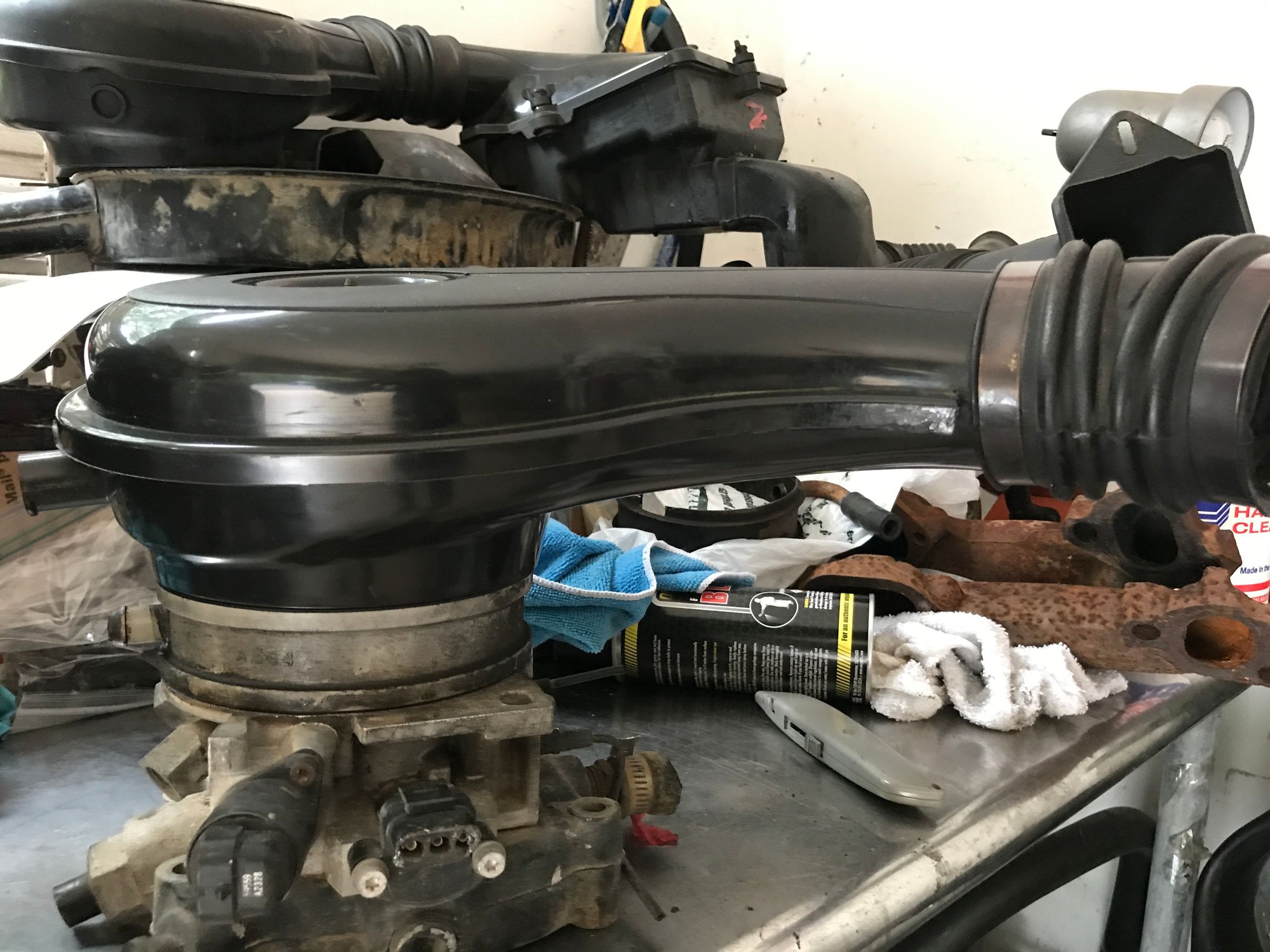

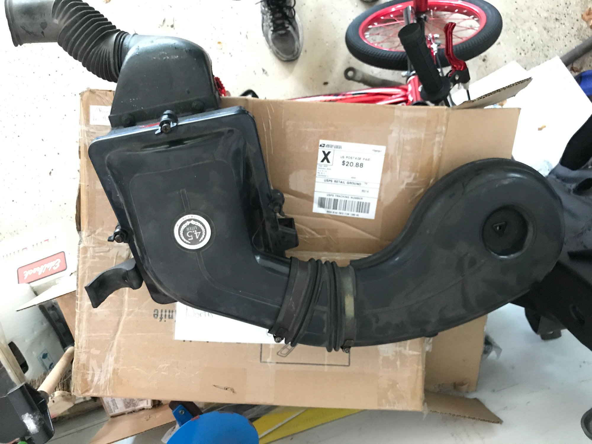

Nice i bought the same caddy bonnet the other day at a local junkyard! Im trying to debate how to plumb it up as well... I might wait and run it with this http://www.hawksmotorsports.com/air-...-w-k-n-filter/
and this https://americansportscar.com/produc...-1992-ram-air/
Yet once again this is 3rd gen haha.
Old Sep 1, 2017 | 11:22 PM
Schurkey's Avatar
Joined: Feb 2011
Posts: 1,589
Likes: 89
Re: SPR Performance TBI
What Caddy did that intake come from? That's the nicest-looking, smoothest carb hat I've ever seen. I want one.
It's almost like it was designed by engineers instead of aftermarket idiots.
Early 90's Cadillac 4.5/4.9 engines. I have an extra if you want to buy it.
