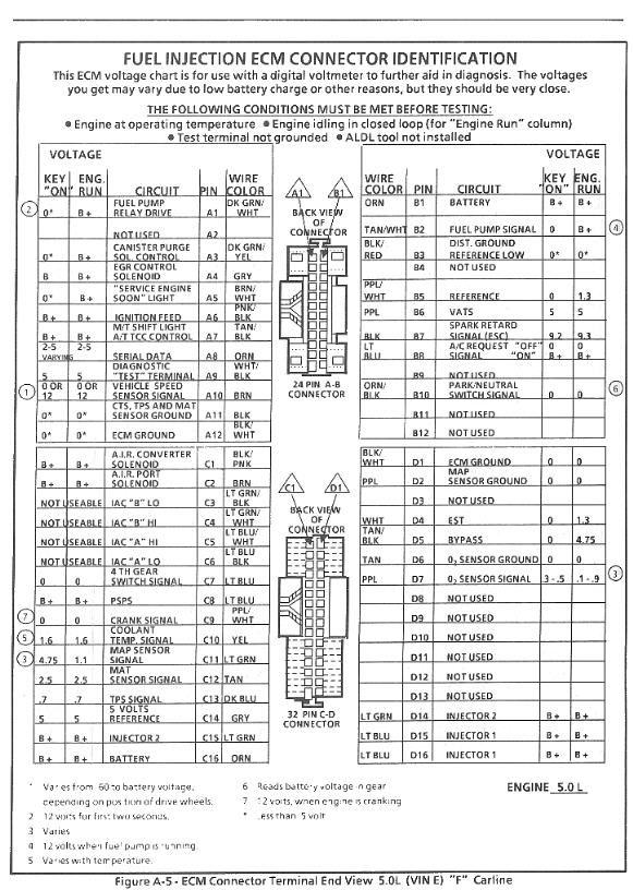

Check pin b6 at the ecm for voltage from the passkey module.
If it’s working you will get 2.5-5v. Another quick way to see if it’s vats is to remove the ecms prom. I will fire up in limp home mode if it’s a vats issue.

can you send a picture? Thanks!

Send a picture of what ?

A pic of where the b6 pin is located and where the connection is found, thanks

The ecm is believed the passengers side dash speaker.
accessible from under the dash.
