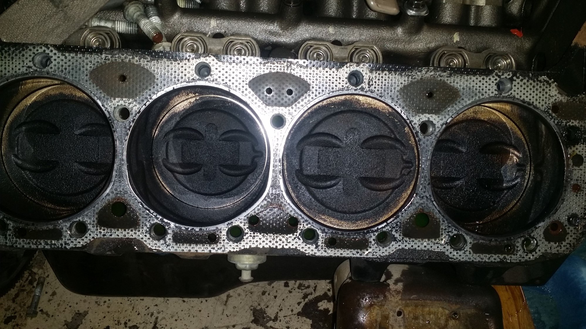

I guess it's a good thing I was browsing in here as I noticed my name was mentioned. I did have a stupid fun 305 TBI back in the day that too be honest, I was just scratching the surface with that build. Here's what I did....
Mildly worked ZZ4 heads with a ZZ4 cam with 1.5 rockers on the intake and 1.6 rockers on the exhaust
port matched RPM intake with a trans-dapt plate and a ported stock TBI unit with an xtremefi adjustable regulator along with 55lb flow matched injectors. I was running the Hooker 2055 headers with an full 3 inch Aerochamber catback. All of this was tuned by the EBL FLASH using a Zeitronix ZT2 wideband run in open loop. It was a damn fun build that put the hurt on many cars. I plan on copying this again sometime later
Old Mar 1, 2021 | 06:04 PM

If I had to do it over again, I would've put in flat top pistons, an xfi268 cam and did some better port work on the heads. Also, I would've went with longtubes over the shorty headers. I think I left a good bit of power on the table with my build.
Old Mar 1, 2021 | 06:10 PM

If I'm to make a different recommendation as it's what I'm building right now for my 91 Camaro is...... go with an LT1 and use the carb LT1 intake. I'm doing an LT355 with ported heads, ZZ4 cam and the GM lt1 carb intake with an adapter plate and a 454 tbi unit.
