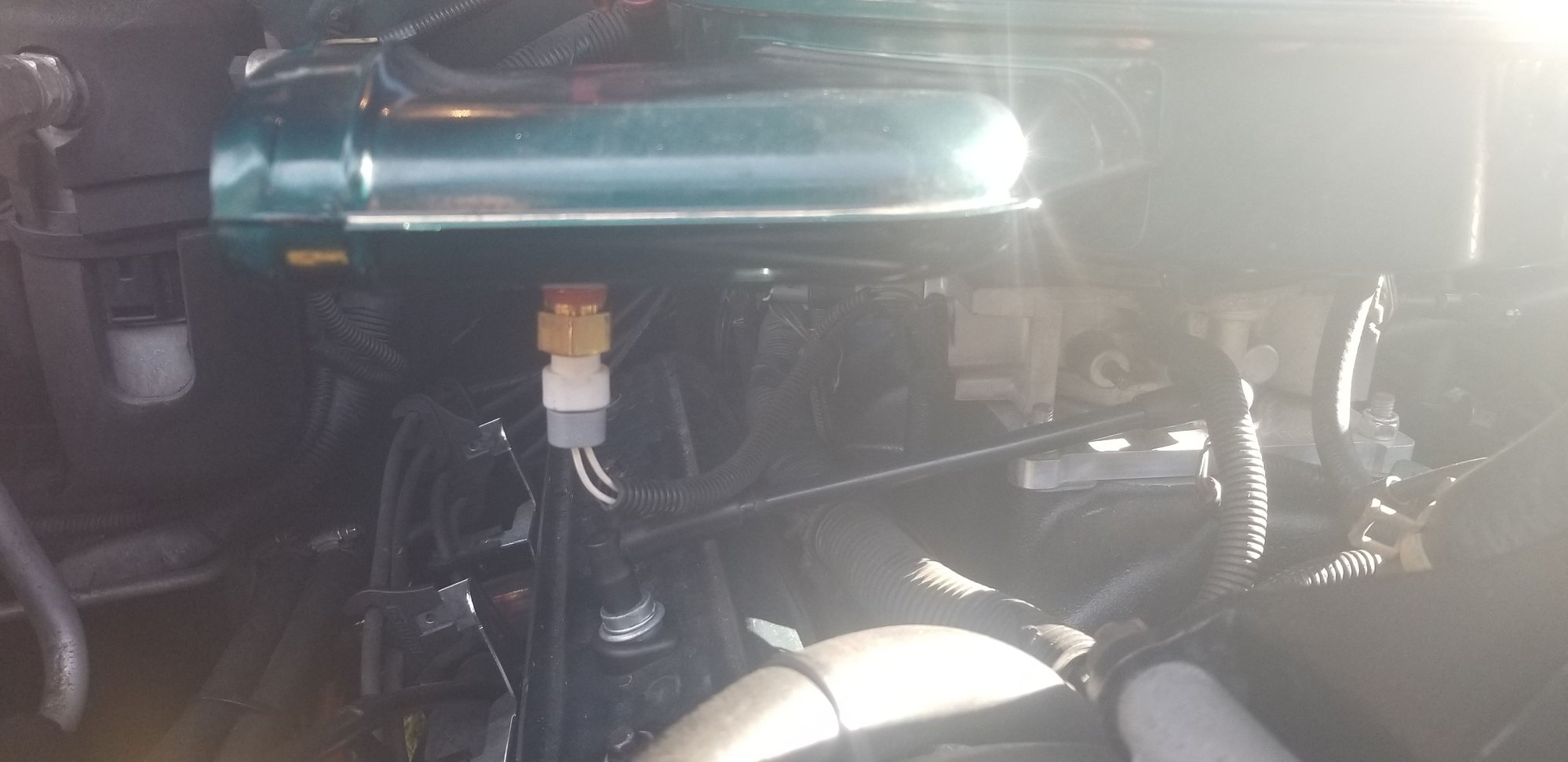

I'm not an expert on the TBI mask, but in TPI 8D, the MAT/CTS blend table is used because the MAT sensor comes factory in the upper plenum, and therefore the MAT sensor gets influenced by the coolant temp (via heat conduction through the metal).
When you relocate the MAT sensor out of the upper plenum into the air duct, you're supposed to disable the MAT/CTS blend table.
Where is your MAT/IAT sensor located?

Cool I just looked and didn't see any way to disable the table but I can set it all to 0 which I imagine does the same thing since the lower the value the less CTS is blended in. I'll give that a shot in the morning, supposed to be in the upper 40's so should be plenty cold.

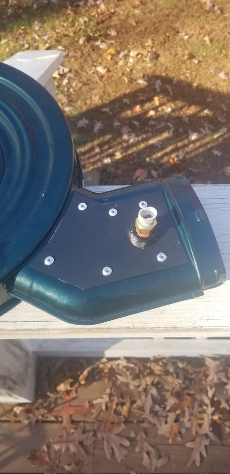

Also just to explain the timeline a little better, I started with my original air cleaner fully functional and had made an adapter and plumbed the heat pipe off the cylinder 2 exhaust header pipe but was running lean so I tried the IAT add on which didn't really help (for the reasons you mentioned). This past week I grabbed another stock air cleaner from the junkyard and ran it along with the IAT and it didn't really help unfortunately. So at this point the only other options I can really find are the old spread bore to tbi adapter from the older bbc trucks that has coolant flow through it and plumb it to the unused port i have on the crossover at the front if the intake or the gm performance vortec to tbi intake manifold that's $$$, I'm assuming it has coolant flow through it but I haven't looked into that intake too much.
