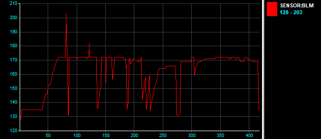

Hello everyone!
I just recently completed a 305 TBI to remanufactured 355 TBI engine swap in my 88 g20 van with a TH400 trans and have been having some issues with inconsistent power production and a possible lean condition. It was stumbling pretty bad during hard acceleration the other day, which seems to have been cleared up by redoing the base timing and idle (although that particular day was much colder than it's been lately so I'll have to try again on a cold day and report back.)
I guess I'm just looking for some clarification and maybe a couple leads/things to check into. Thanks!
- Fuel pressure was measured at a consistent 12psi at idle, cruising, and WOT during a 20 minute test drive. Unfortunately the fuel pressure gauge must have broken after that first drive because when I went for another drive later that day, the gauge was stuck at 0psi the entire time. For now lets assume fuel pressure is ok.
- No drips from the injectors, spray pattern appears to be a nice cone shape and consistent, but I'm no expert so take that assessment with a grain of salt.
- BLM was pinned at 172 for most of the drive, with periodic dips to the 135-150 range under ~75%+ throttle.
- INT was jumping between 125-150 for the first 3/4 of the drive and then it seemed to stabilize around the 125-135 range for the tail end of the drive.
- Power felt pretty solid and throttle was responsive during the entire drive (again, it was 45-50 degrees that day, I'm curious to try it again when its 35)
- I'm still in the process of investigating vacuum leaks but almost all the lines have been confirmed good and vacuum at idle is about 20"
- Base timing is 0* BTDC (potentially a hair advanced, maybe 1*) and base idle in drive goes between 750-500RPM depending on how long it sits at idle.
I guess I'm still a little cloudy on how the BLM could be so high while the INT is just a little high/kind of close to 128. Do I just need to drive it more so the computer can get used to it's new home? It's a remanufactured engine that I've put 100 miles on so far and I'm just paranoid about glazing the cylinders if it is indeed running as lean as the BLM would suggest.

1. The computer is in "rich command", but that doesn't mean the engine is actually running lean. It means the computer is compensating for (correcting) a lean condition that may or may not exist any more. If the Integrator (short-term fuel trim) goes to rich-command, the Block Learn (long-term fuel trim) goes richer. If the Integrator is still rich-command, the Block Learn continues to go rich-command. Eventually the Integrator becomes happy, leaving the Block Learn semi-permanently rich-command. So, yes, the short-term trim doesn't need to go rich-command because the long-term fuel trim has adequately taken care of the leanness. The "sucking" sound indicates a vacuum leak; but they typically don't come-and-go intermittently. Worth investigating.
2. WHICH "new" knock sensor did you install? At least in the light-truck world, 305 uses a different knock sensor than 350. Was it properly torqued to spec with sealer on the threads? Over- or under-tightening will change it's sensitivity.
3. Fuel pressure is within "spec"; assuming your gauge is accurate. Have you verified the gauge actually shows 12 psi when connected to a verified 12-psi source? Pressure gauges "can" be wildly incorrect; and things have not gotten better since the Communist Chinese have flooded the market. Additionally, it's not unheard-of for a vehicle to need more fuel pressure than "spec" calls for--although that's typically needed when the engine is more-modified than yours.
4. False "lean" signal to the computer often happens when A) the O2 sensor is faulty; or B) when the engine is misfiring. Therefore...
5. ...Connect a scan tool, verify ALL the sensors (especially coolant temperature, MAP, knock sensor, and O2.) Assure that the spark advance is working, and not getting excessive spark-retard from a goofy knock sensor. Have you assured that the EGR actually works, and is the correct style for the engine? (My '88 K1500 5.7L has a "negative backpressure" EGR valve, I assume your 5.7L needs that also.) Your variable idle speed--500 to 750--indicates potential problems with the IAC; or may be related to the vacuum leak(s).
6. No idea how a chip for a 700 trans will interact with a vehicle having a 400 trans. There'll be no torque converter clutch to control, for example.

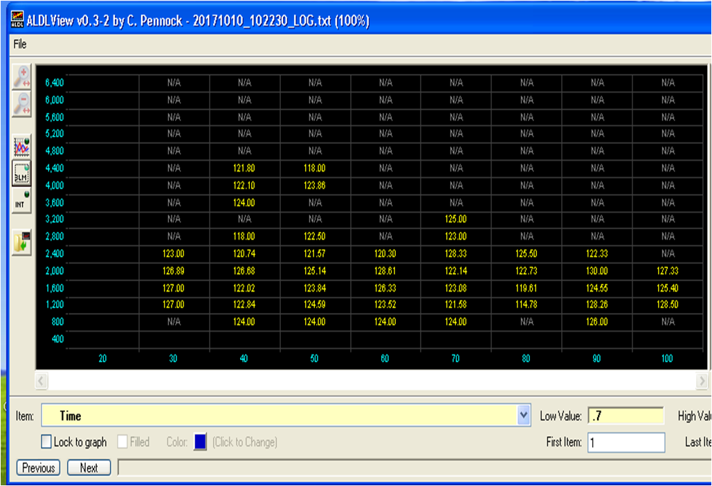

You can also reset the computer by disconnecting power to it. You'll then start fresh with 128 BLM/INT and see where it goes from there.
Once the BLM settles in to it's long term fuel trim, the INT will re-center to 128. Basically the INT chases the O2 sensor and the BLM chases the INT.

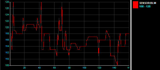

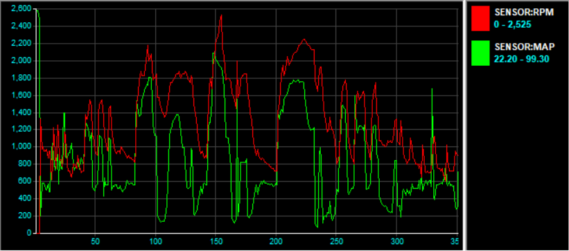

BLM with the undersized injectors
BLM with the correct, 5.7 injectors
Posting this for posterity.
Comparison between the 4.3L and 5.7L injectors.
Definitely a no brainer, but interesting to see nonetheless.
Now I'm wondering if it's running too rich. I got these injectors from CFM Tech and they were supposedly cleaned and flow matched, but the pods have a different look than the other injectors I have. No GM part number stamped on top, slightly different color metal, different looking tack welds on the bottom of the pods.
To answer this specific question. No, the computer (ECM '7747) does not need to get used to it's new home. It is an antiquated thing and as no self learning capability. Only one engine cycle from cold to warm is enough. The BLMs (Block Learning Mode) are constantly updated, in closed loop, and only the last data is kept in memory (not an average) when engine is shut off. The BLMs represent small to larger areas of engine load and frankly are inaccurate. They are divided into 15 cells (blocks). BLMs are constantly updated as the engine travels through the cell areas.
The BLMs are updated based on the INT. The INT reacts instantly to lean/rich condition and adjust. BLM will be adjusted depending on what the INT is doing and at what rate. So a high BLM with INT around 128, means that the BLM has been updated using INT. The INT does not need to adjust anymore as the BLM is doing its job. Prior to your BLM going high, the INT must have been tapped out on the high side. Only a data log would confirm that. Also, the BLMs can vary as the cell# changes.
Formula is like this: INJ PW * BLM/128 *INT/128.
INT reacts based on O2 sensor voltage windows in closed loop. The windows are programmed to achieve stoichiometric combustion. The O2 sensor only monitors 1 bank on OEM set-up and needs to be hot enough to function properly. O2 sensor can be fooled and malfunctioning which would throw the BLM/INT off.

My fuel pressure is steady at 12psi currently, maybe it's a hair too high for the current tune?
I would not worry about the BLM values you are seeing. I shoot for ~124ish anyway when I tune a TBI. They change at whim with the weather and intake air temperature as well as intake manifold temperature. Better to stay on the rich side and let the ECM pull a little fuel than be on the lean side.
