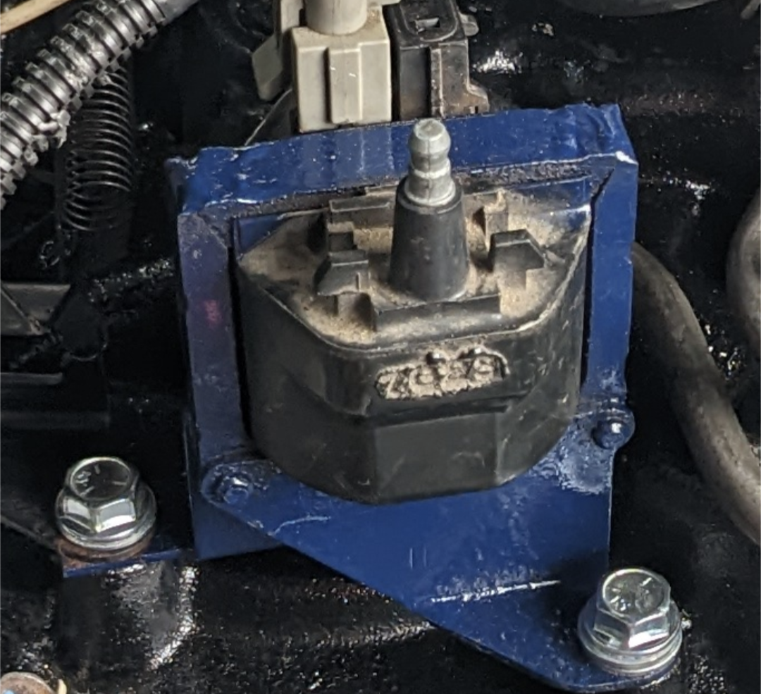

I can't seem to find a bolt that threads into the coil bracket bolt holes on the later style stock TBI intake (the one that takes the distributor that has a separate coil) I'm planning on using for the time being, so I'm wondering what size it's supposed to be. I think paint got in the holes when I painted it so that's why I can't get either a metric or SAE bolt to thread in. I need to know the correct size so I know what size thread chaser to chase the threads with to clear out the paint without ruining the holes.

you're talking about these guys, right?
If I recall correctly, these take a 1/2" socket, so I believe that's a 5/16" coarse thread. Pretty standard. They're pretty shallow holes, I had to stack a washer or two to be safe.

But honestly they could just as easily be 9/16" like mostly everything else on the intake.
It's one or the other.

Turns out they are just 5/16"-18 holes, the same as the mounting holes for the throttle body. I figured out the throttle body hole size and thought the coil hole size had to be the same since they are so close together and so I chased the coil holes out with this size, and after I got the chase started on them it thread fairly easily.
Seems like the Chevy V-8 engines pretty much stuck to SAE threads on this generation of V-8 even though the engines went in cars that had already gone to metric threads by this time.
