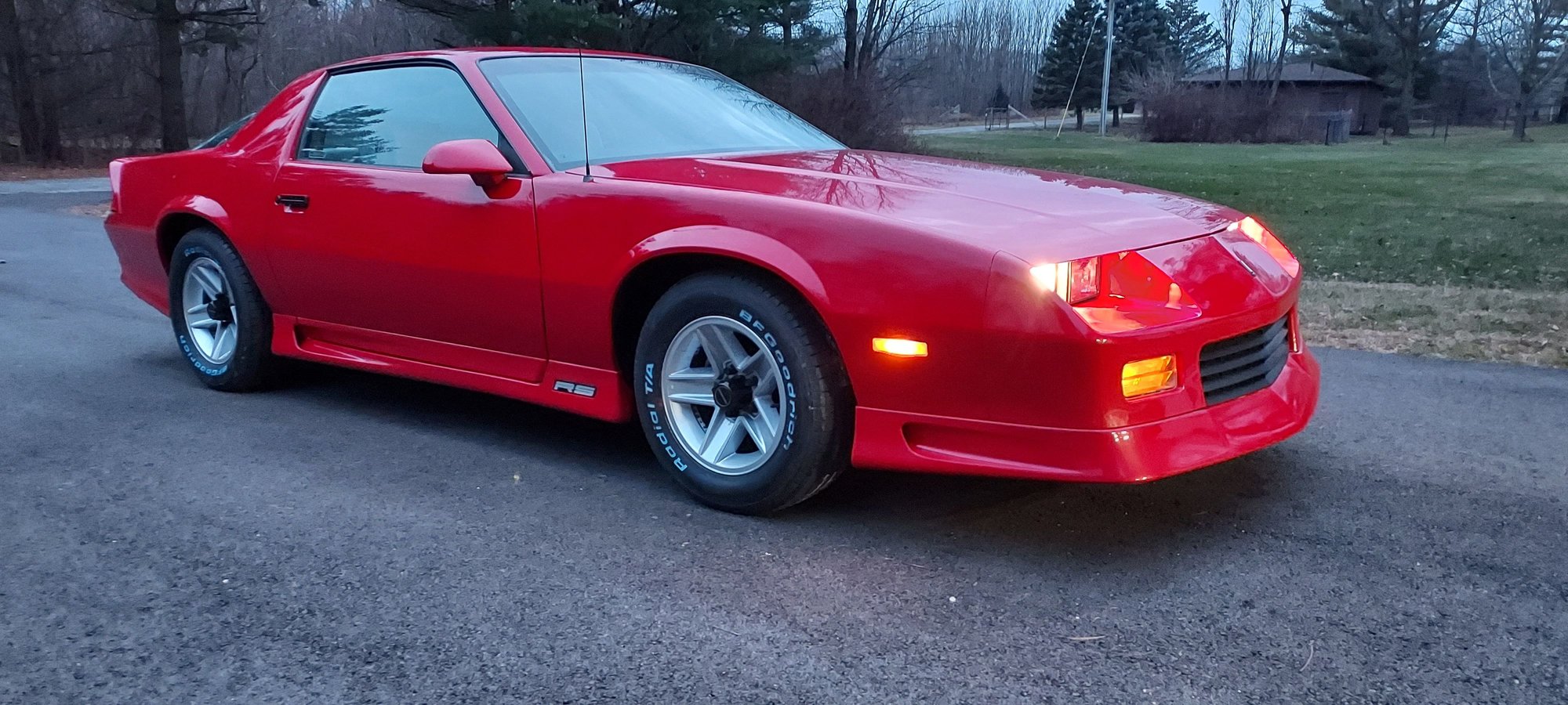

My 92 305 TBI RS starts runs fine most of the time. Once the engine is hot and the outside air is above 75 when I shut the car off it won't start. I was riving the car early spring in 55 degree worked fine. It has spark and will fire on starter fluid but has no fuel. Once the car sits for an hour or so starts back up runs fine but will do the same thing once it's shut off again? Once the car cools off completley the cycle repeats. Any ideas?
Thanks in Advance!
