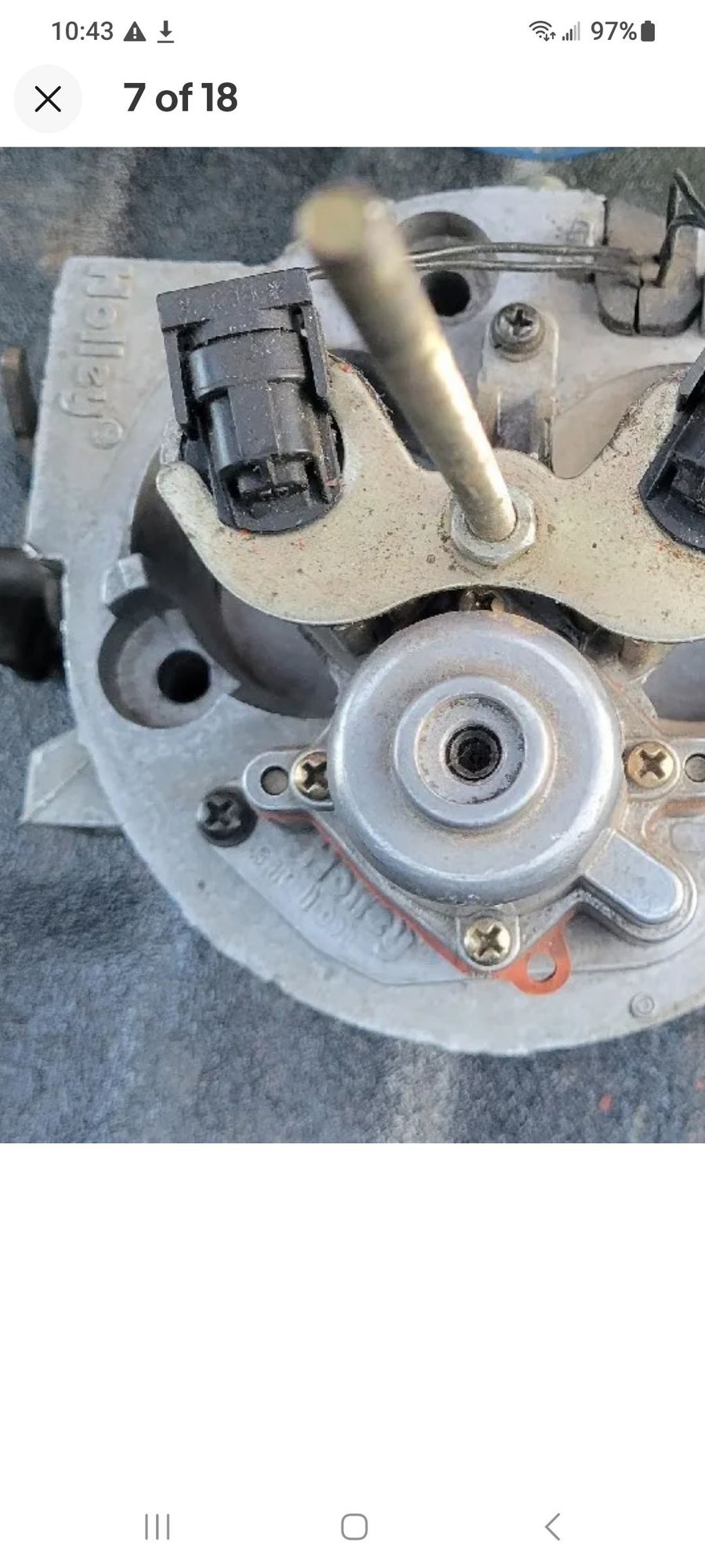

here is a picture, not a great one but it's currently pouring out. The part # ends in 5389. I been searching that on here and I believe there 60lb. But I might need to find that post about the holley injectors again. Thanks for the input, much appreciated. I did order a TBI tappered aluminum spacer. I can at least make sure this thing works. The guy I bought it from knew nothing about it. Then said maybe 90's truck, a friend gave him a box of parts. So I like to make sure it works with the spacer. If tuning goes OK, it works good, maybe I'll have the intake bored out. One step at a time I guess. If it don't work I'm out $160. But as long as it works, I can resell if needed. I just took a chance at this. Figured it would be a test. Will I see any improvement, especially with a tb spacer, most likely not. Lol. The unit is pretty clean but these castings are a mess on the outside.

Those are the newer-style (better) injectors.

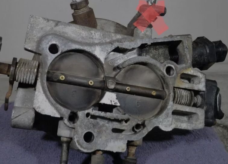

Transmission: 4L60
Re: Holley 670 TBI
Whatever you do when you go to install it do not use the port I marked with a Red "X" for the MAP sensor. That will cause cold start flooding and a rich/rough idle as that port is shared with the IAC. Instead pull the vacuum for the MAP
off one of the full manifold vacuum ports on the front of the TBI unit.
