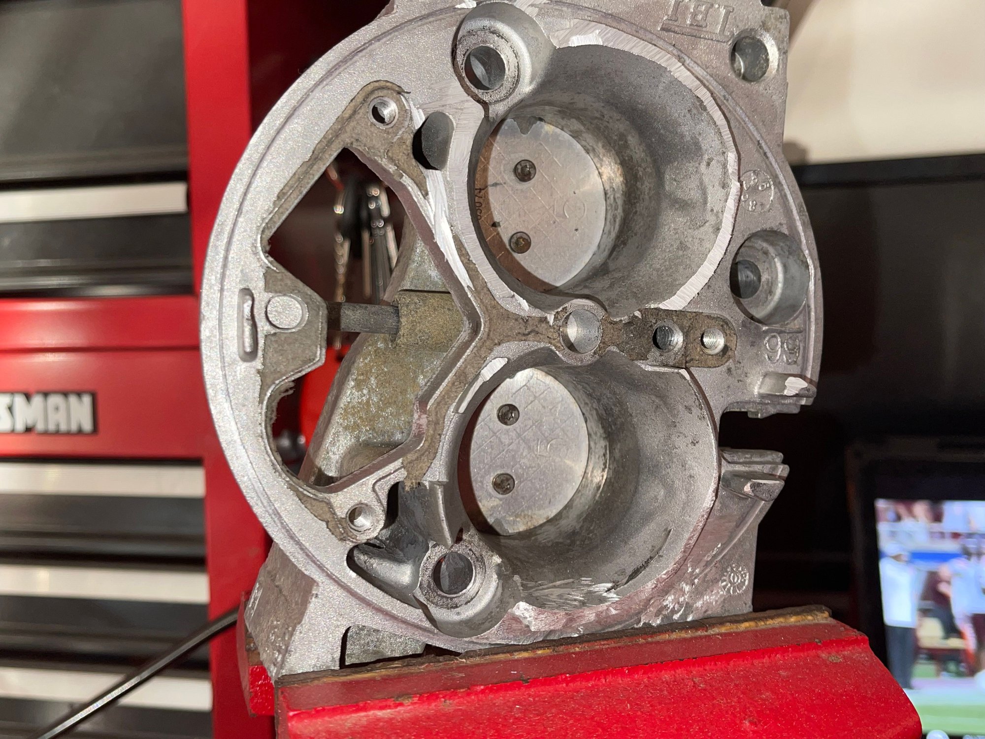

I am in the middle of rebuilding a TBI and doing the ultimate TBI mods. Has anyone used 350 injectors? Any tips, tricks, or issues to be aware of?
Is there any actual evidence that the "ultimate TBI mods" do any good?
Strikes me as wasted effort, with the side effect of screwing-up the anti-corrosion plating of the throttle body.
Everyone with an OEM 350?
Get the fuel pressure "right" for your application.
Make sure the gasket surfaces are actually flat. The upper cover is especially susceptible to warpage.
Assure that the throttle shafts are not running on worn-out supports in the casting. (i.e., throttle shaft "bushings" wiped-out.)
Use the correct base gasket for your throttle body casting.
Pretty-much everyone who dicks with the base-idle screw later complains about idle problems.
