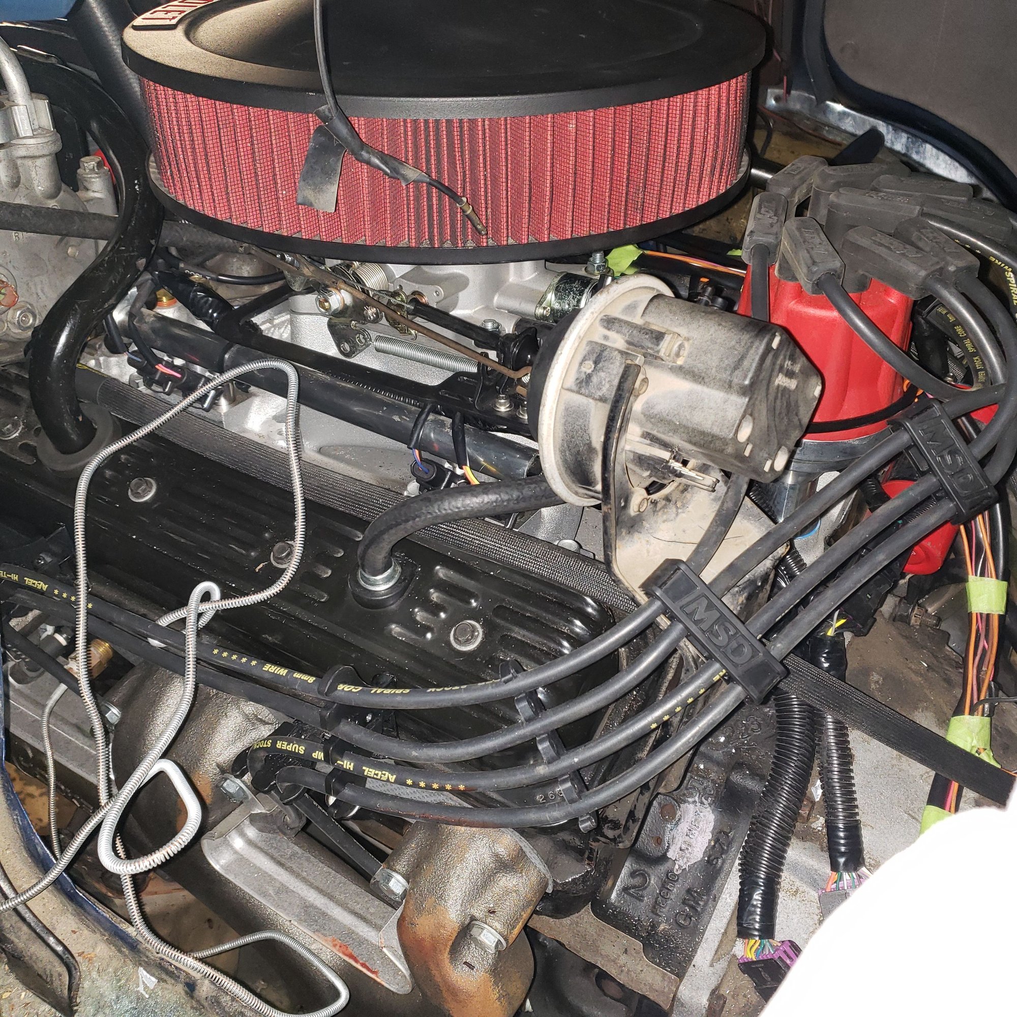

Granted it is on a different setup now with a TH400, this is the bracket I ran on the RPM/Marine TBI adapter/Marine TBI unit setup. Pulled it out of a bin of spare TBI parts I have laying around the shop to use for this setup. The cruise control on this one is a cut-down stock GM setup and the throttle cable bracket is a universal 4150 style. It comes with smaller brackets that bolt on for both the cruise control cable when remote mounted like a F-car and TV cables.
