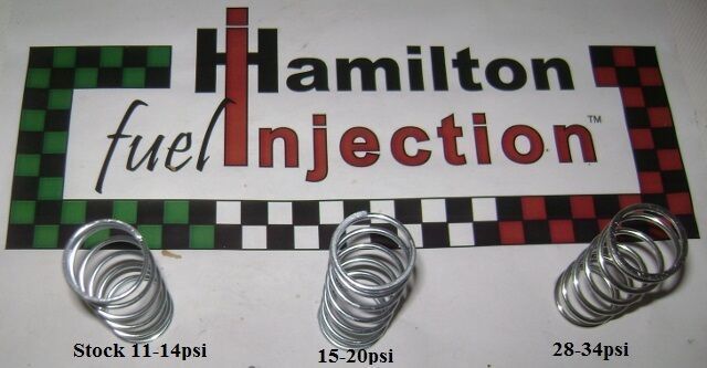

Old May 3, 2024 | 08:54 PM
stew'86MCSS396's Avatar
Joined: Sep 2002
Posts: 253
Likes: 25
From: honolulu
Car: '86MCSS
Engine: 396 .030"
Transmission: M20
Re: 1989 camaro 305 tbi massive engine surge idle and driving.
Typically the stock pump will not make more than 18 psi. Everyone seems to think more is better and install a TPI pump that can produce pressures >43 psi. It's the FPR that regulates the fuel pressure as it name implies. Perhaps you have the wrong spring in the FPR or maybe a restriction along the return side. The 20 psi will create a rich/over fueling condition...but I'm not sure if that would create the symptoms that you're describing.
Click image
Click image
hi. it took a while but my mechanic put an adjustable regulator to get it in spec. From what i can recall it did not make a difference. I recently got a OTC monitor 2000 and the block lean multiplier is indicating a slightly rich condition but we are currently trying to figure that one out. Currently before the car broke down again today it was running somewhat ok after my mechanic replaced some faulty new fuel injectors and the ecm. Still acts up but I call it a compromise.
