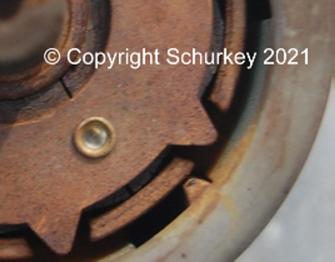

No spark, no injector pulse is USUALLY failed distributor parts--either the pickup coil/magnet, or a failed ignition module. There could be a wire-harness problem. However, failed pickup coil magnets are EPIDEMIC with TBI distributors.
Sometimes they crack all over. Typically, the magnet cracks where the rivet passes through.
Typical TBI V8 distributor pickup area.
Magnet cracked on either side of the riveted area.
There was a time when you could buy a new distributor mainshaft, which got you a new shaft, new pickup coil, new reluctor, and a fresh rotor. Those have been LONG discontinued. About all you can do is to search the Treasure Yards for a usable distributor, or take a chance on some aftermarket distributor.
