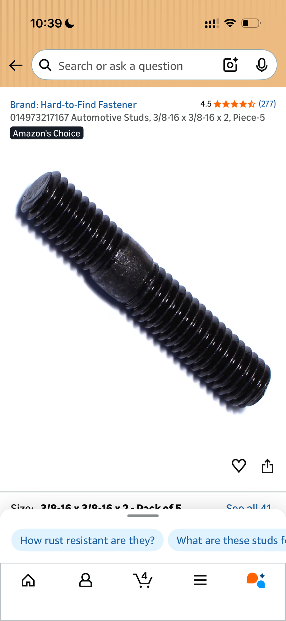

I just completed my Hedman header project on the same set up, and I ordered a stud kit on Amazon that had the same thread pitch but it allowed me to thread in the nut that retains the accessory brackets. I did need to alter the some of the screws a tad to install the nut and bracket properly, but it ultimately worked for me!
if you decide to order these - just confirm your thread type (should all be the same for sbc)
