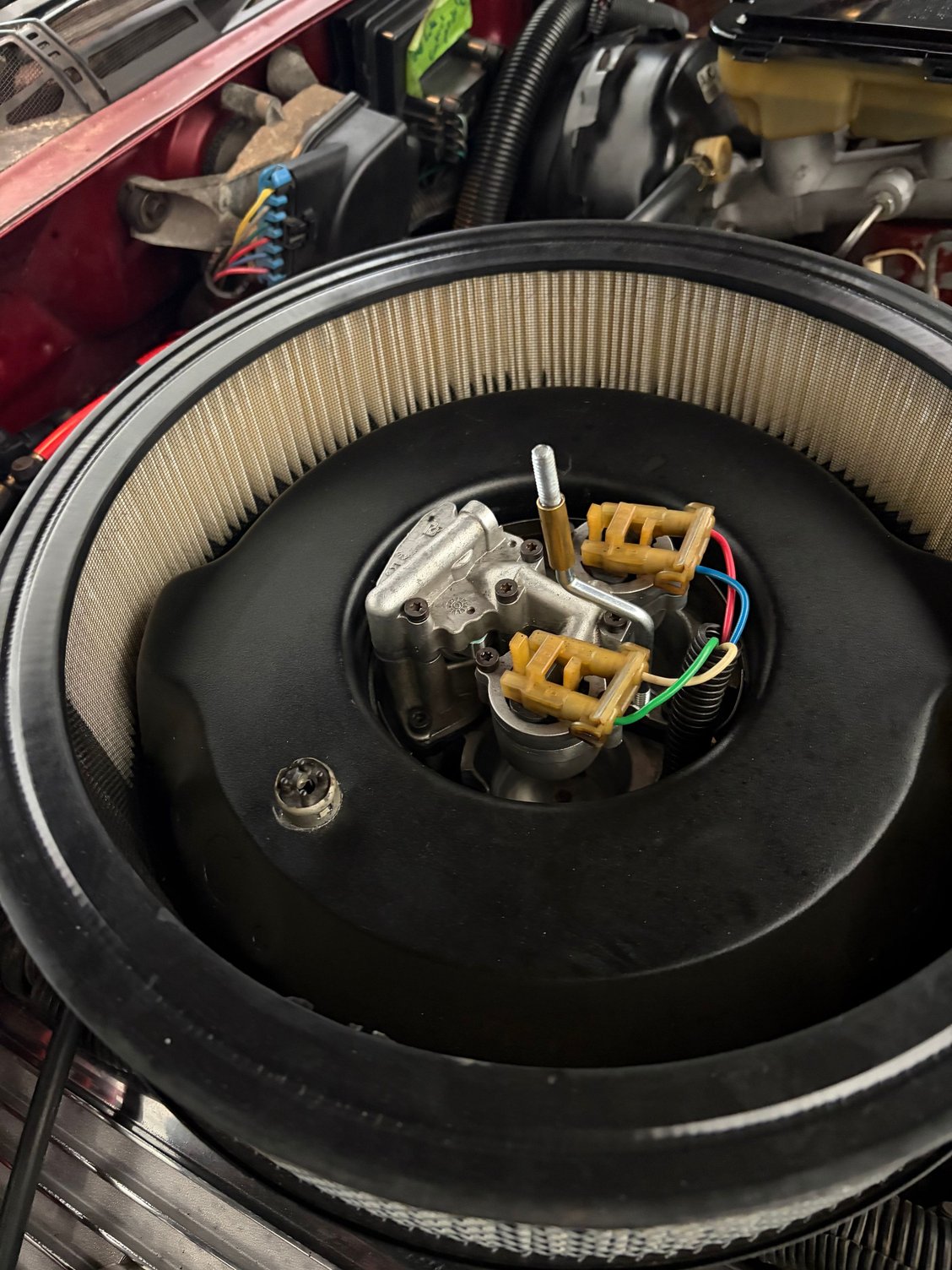

Hey guys,
I’m having a heck of a time trying to diagnose what is going on with my 1991 5.0 TBI Firebird Base Model.
When accelerating under any load the car seems to not fire properly or maybe it’s bogging (I’m not sure) but it accelerates fine in Park and Neutral. It is almost the same feeling as if you were driving a stick shift, and you were in too high of gear for the lower speed you were going - it just seems to not get any acceleration / power.
If you press and hold the accelerator for too long, it will keep bogging or whatever it is doing, and it will eventually stall out.
The only code I am getting is GM 12.
I have replaced the following to try and remedy this problem but none have seemed to work.
Rebuilt and cleaned entire TBI
New AC Delco fuel injectors
MAP Sensor
Throttle Position Sensor
IAC valve
EGR Valve
EGR Solenoid
Inner Air Temp sensor (air charge)
Engine Temp Sensor
Fan Switch
02 sensor
thermostat
Distributor
Spark plugs and wires
All New fuel lines, fuel filter and upgraded pump.
I have replaced all vacuum lines hooked to TBI and EGR
Installed new fuel line with an external regulator that regulates pressure at 13-14 psi (even under load) I’m getting plenty of fuel. I Platted off the internal fuel regulator (it was doing this problem before I messed with the fuel regulator)
The only solenoid I haven’t replaced is the charcoal purge canister.
What in the world am I missing here?
Someone mentioned the torque converter… why would this affect acceleration under load?
Any help would be much appreciated,

That car is starving for fuel. IDK if I trust that fuel pressure gauge, or if it's connected into the wrong point on the fuel system (or maybe the Port going to the TBI unit is the wrong one and you have ~14 lbs, but not at the TBI? You can hear the sound/symptom of it starving, the RPM starts to fall off, then you can hear the injectors blast for a second, and then the engine recovers. It's starving for fuel. You need to figure out why. What happened to the car when the symptom started? What mods or changes did you make? I would re-run that same scenario that you did in the vid, but with a fuel pressure gauge installed in the line going to the TB....of even AT the TB. It looks like you may have a single fuel hose running to the TB...do you? If so, what have you done w/the return and FPR on the TBI unit?
Appreciate the response / so I have the return line hooked up to the return port of the fuel regulator that sends the unused fuel back to the tank. Single main fuel line going back to the throttle body. I have a internal fuel regulator “block off plate” installed. (See link)
https://www.hawksmotorsports.com/tbi...s-motorsports/
Brand new fuel pump and filter. It was doing this long before I upgraded the fuel system. I have even gone as far as installing another pressure gauge (farther down the supply line right before the Throttle body inlet) and it’s right at 13-14 even when accelerating in park. I can’t tell when driving under load and in gear.
The whining noise is the intake sucking in air. It’s wild, but after it warms up it’s fine. But once I drive it still has the popping exhaust symptoms while in gear.

I mean, it's idling perfectly. How are "the cylinders firing when they're not supposed to"? AKA, wires hooked up wrong.
No, the thing is starving for fuel. It needs more fuel. I'd bet $20 bux that it's backfiring through the intake when he steps on the gas in gear.
I think that I would start by putting the stock FPR back on.

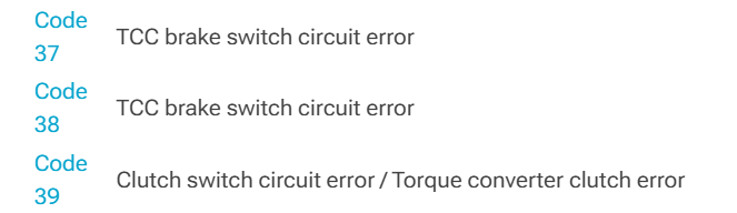

So I have the GM plug-in code scanner. But all it shows are the codes on the dash. (Which is none) except for 12.
i thought a faulty O2 sensor and a rich / lean condition could through a code.
would a fault TCC throw a code?
Take a look at this @DynoDave43 @Tom 400 CFI the first clip is idling.
Then I set the car on jack stands and put into gear and revved. This is that whining hissing noise you hear.

@Tom 400 CFI Just an Obd1 tool that triggers the flashing engine light on the dash. No codes except 12. Which I believe is normal flash test sequence code.
So I’m assuming this is not necessarily a true scan tool but simply a code tool. Do they make an actual realtime diagnostic scanner for Obd1? I didn’t think those existed.
Also, I got a video of the fuel gauge while driving under load. No needle movement at all from 13-14 psi. I’ll upload it tomorrow.
That leads me to believe one or two things that are not working properly. But I am certain now it is starving for fuel under load: not to mention the smell of the exhaust is more carbon than raw fuel.
1. The TBI is just old and shot (not convinced because I installed New Delco injectors and rebuilt the entire thing with a Delco rebuild kit)
2. The IAC /TPS is faulty.
3. ECM sending wonky signals?
I am so close to scrapping this damn thing and installing a performer manifold compatible with a nice carburetor or even save for a few months and just convert to a Holly Terminator X FI system.

I don't have my factory service manual (fsm) here with me, so I'm not sure if TCC can set a code or not in our model years. OBD1 lasted until 1995, and continued to grow. So one always has to be careful when "consulting the internet", but this GM chart of OBD1 codes does show a couple of circuit fault codes.
I'm no expert, but my experience with TCC has been that it won't engage, or it stays engaged when you come to a stop. I've never seen one cycle on and off, that might create a sort of surge. Not saying it can't happen, just hasn't been my experience.

I did get a video of it under the hood - I thought I uploaded to YouTube but I just checked and I did not. I only uploaded the one in gear on Jack stands.
It shows the fuel pressure hovering around 13-14 psi and when I easily accelerate the psi 12. When I really mashed it, it maybe dropped to about 11 or so. Would that much fluctuation cause that sound it’s making and feel like the car is stumbling?

boy that sounds like weak fuel pressure, try spraying carb cleaner down the tbi as you rev it. Any chance the map sensor is on a wrong port or clogged port? Tee in a vacuum gauge there.
