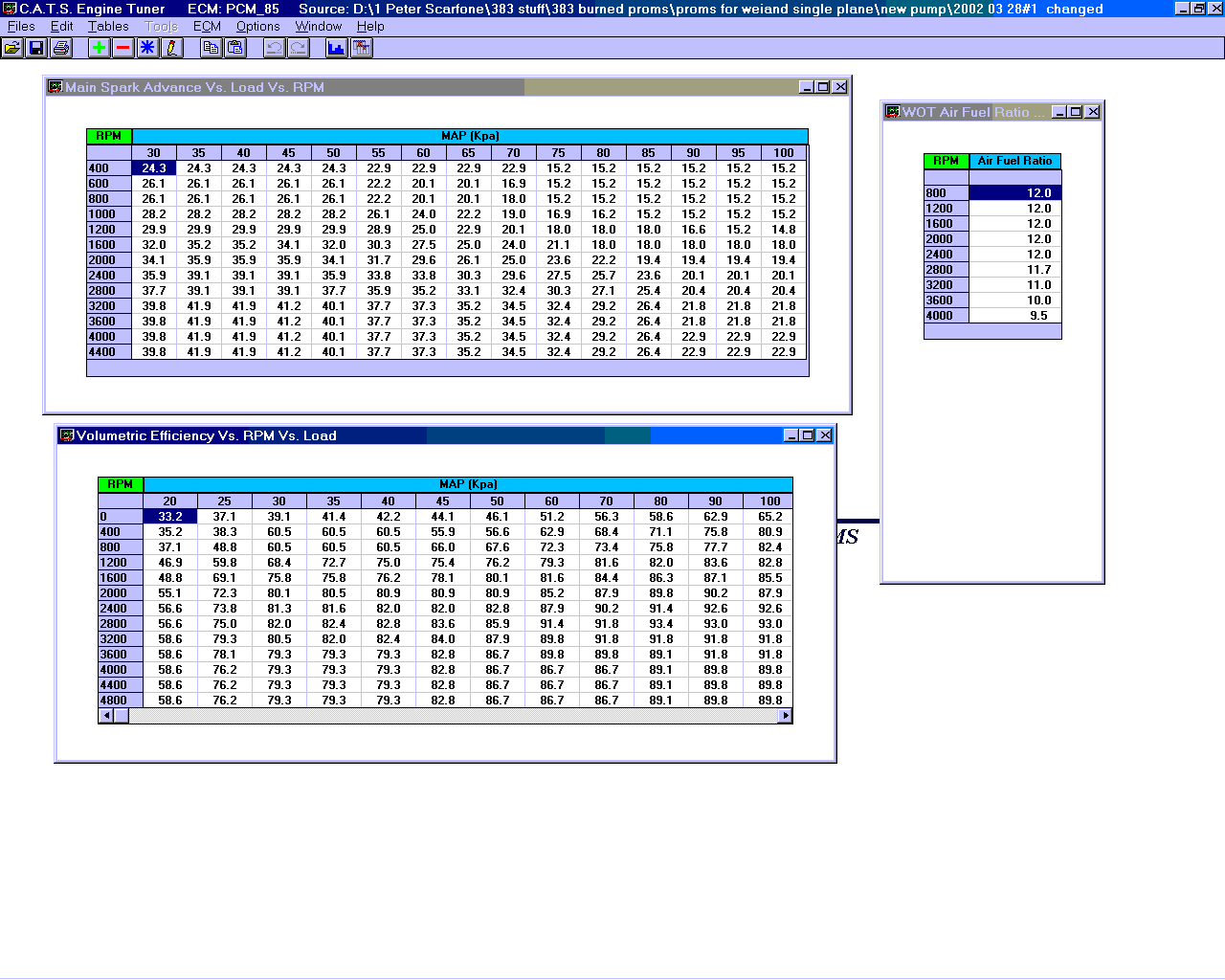

reloaded charts
here are the reloaded tables

What are all the specs on this motor? What injectors, heads, cam, all that good stuff.
If it's in another post, could you be so kind as to save me some time and include a link to it. I'm working off of a stupid AOL dial-up (only for spring break).
Thanks

I'd say it's a 383 with a Weiand single plane.
just bustin yer *****.
