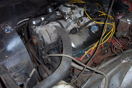

here's the thing i just pick up the car, the owner said the motor has been rebuilt already. the only thing i can think of is he rebuilt everything except the heads, and just slaped the stock ones on. oh yeah the car was run with a header leak for awhile, could that be the cause?
Old Apr 15, 2002 | 04:59 PM
JAY87GTA's Avatar
Posts: 411
From: Bartow, FL
yeah, if it's leaking on that side it could have burned an exhaust valve
