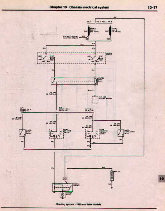

Old Apr 25, 2002 | 01:57 AM
Snowdog 91 Formula's Avatar
Joined: May 2001
Posts: 757
From: Las Vegas, Nv. USA
Here is the diagram:
Attached Thumbnails what else could go wrong...100 bucks to the person who can help fix my problems!-10-17.jpg
Old Apr 25, 2002 | 02:09 AM
Joined: May 2001
Posts: 757
My theory is:
The BLK wire attaches to the positive link on the battery to the starter. Assuming it is not the solenoid, the loop continues.
At the ignition the switch goes into a starter enable relay hooked into the VATS. (pass key decoder module) which goes to the gear selector/clutch start switch.
That completes the circuit.
The full voltage is only allowed when VATS allows the gate to connect.
If not, only VATS has voltage.
VATS has to read the key!
It needs power. It gets power when you turn the ignition key!
It will not allow 12V to pass if it fails!

I still think the braided ground strap is bad. If it is still there and looks good on visual inspection, that dosent mean it is good.

Starter, I dont care you are obviously stating you have a problem with your starter, ripp the junk out, return it and get a whole new one. If the starter is Brand new, it shouldnt have any problems turning over a High Compression engine, but you never know, now would be the good time to just get a MiniStarter, so you have eliminated the problem of it not being able to turn it over, because of compression. 2 down
Grounds, Go back take off all the Grounds and clean the surface with a wire brush, if you did it once do it again, so you know you are positive that they are all good, clean the threads of the bolts with a wirebrush too. You should have 1 on each Head and then your main ground. 3 down
Fusable links, I have had these go out, but I would receive no power to the Starter, but I would have power to the accessorys. Easy test to know when there bad, they can stretch like Rubber.
There is no point in ripping out your harness in checking around it.Yet!
I have learned 2 things, one that my dad told me, that I never listened too, "If your gonna do it Half assed, dont do it at all" and "Theres no cheap way of getting a expensive needed part"
Buy yourself the ministarter, you are goin to find that if you have high compression, it is going to get hot and it wont crank over. I would run into this all the time, when I would drive it to the Track, which is about 20 miles away, I would get there, turn my car off, and then try to start it and nothing The only thing that could jump it was a Big *** Tow Truck, no other car would work, it needed that much power

The outcome is no good. Friday I pulled wire harness, checked all grounds( by checking I mean cleaning up even more paint regrounding to different locations, everything else you can do or thank of), traded in new starter for a even newer one, charged up battery and still same problem. When harness was out I took all looms off to check for pinched,broke or burned wires but nothing wrong. I have determined it is inside the car. I am back to thinking it has something to do with alarm disconnect. Tomorrow I have to fix up the girls car but after I am done with her it is back to mine. I am almost ready to blow it up!!!! For a swap that is so easy according to some this is really a lot of to fight with. From everything I have read, seen, done, and belived this is a pull the old one, drop new, plug and play, but the car g**'s must be real pissed off at me, since I am moving into a month of playing with this $hit
