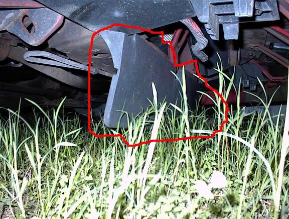

It still overheats.. So i run the AC so my fan stays on at all times. AC dont work so it outs out heat also... Anyways my car will still overheat sometimes with AC on... Im not sure what else it could be... Maybe radiator? Or the air dam underneat the car... Could someone send me a pic of the air dam on a 88 Camaro sport Coupe? Mine dont seem like its right. Seems like it is missing a peice making it not scoop the air... Thanks

Look for pics of your airdamn in the appearacne forum .If you dont see any run a search on them , if still no luck , make a post and ask for pics .

Here's an air dam pic..
Try replacing your radiator cap, and check your lower radiator hose, to make sure it's not collapsing under high rpms.
