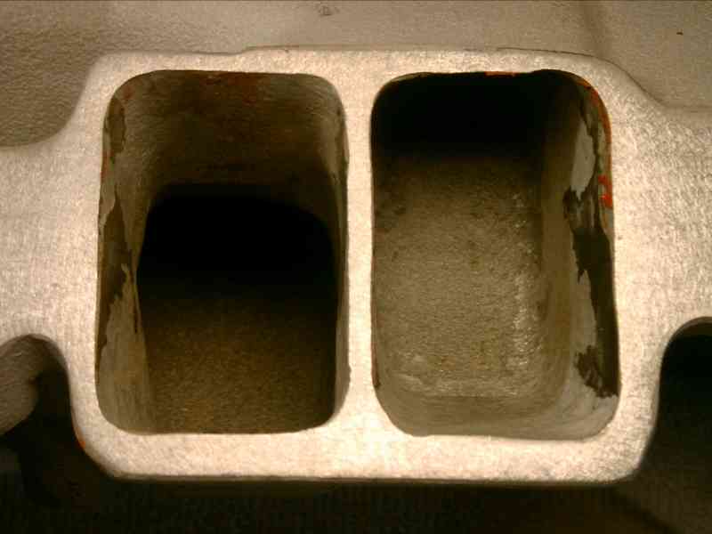

I bought an Weiand Action Plus 8004 intake off ebay and I was wondering if it is junk?
The devider in the plenum was milled out for "Nitrous use" but it has been brought to my attention that if you remove the devider you ruin the manifold. Also with the newer plate system the devider is not in the way anyway. Also it claims for better nitrous distribution with the devider remove but I also heard if your running less that a 150 shot it does not matter. I am running a 50-75-100 so I should be fine there. If need be could I weld a devider back in???
The runners have been "professionally ported" (by a blind man!) Are the runner trashed??? The look to be ported to the ragged edge. I am wondering if a gasket will hold with the amount of material that has been removed. It also looks like they used an epoxy (Black Stuff probably JB Weld) to touch up the port job. It looks like chunck have broken off the epoxy. I am afraid more chunck will come of and get sucked into the motor! Is this a lagitimate concern?
What are your opinions on this intake? Is it ok as is? If not can it be salvaged? Or should I just throw it out? I will probably bitch to the guy that burned me on it!

here is a PIC of one set of runners (probably the worst ones)

It looks like you will have a lot of trouble getting the ports to seal, not a lot a material left. I would be very worried if it has JB Weld patches, I doubt that stuff will hold. If it was me, I'd rip the seller a new one .

I think you might want to try to get your money back. I would not use that thing.

Intakes are too cheap, and if is JB, you for sure dont want it going down the hole.
Just get a new one.

I would be more worried about the porting job than the divider. If it was just the divider, I'd say toss it on the motor and see how it works. With the hack job done on the runners, I think it's time to get your money back.

I was saying the same thing to myself when I saw the photos, "Wow! What a hack-job."
This was "professionally ported"? What "profession" were they in, ditch digging? Doesn't Ebay have some recourse, other than the seller's feedback?

The guy email me back saying I was out of luck and the part was sold as is. So I emailed him back bitching some more. I think their may be area within ebay to file a complaint against people who sell junk parts. Their are even trashed threads on this intake that he made no mention about. What a dick! I may have to knock and grind all that black crap off and give it a try with some extra gasket sealer. If it develops a vaccum leak I'll probably just buy a NEW one.
