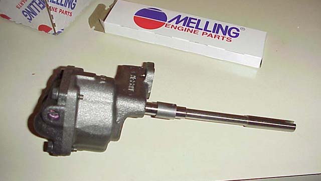

If I remember right (been a while) yes it should.
Unlike the plastic sleeve setup, the metal one is pinned to the shaft, and dosen't require you to lock it in.
But I'm going on memory from a couple of years ago. Anyhow I'll post a pic I took of the pump w/shaft & metal sleeve.
Maybe someone else can confirm that the metal sleeve setup just slides on.
Ron
Attached Thumbnails Will an aftermarket oil pump driveshaft install from topside?-mvc-059x.jpg

you won't like this but no, at least the arp ones i use won't

Well, I got the melling one from O'Reillys today and it doesnt fit in from the top. I guess for now I will have to run with no sleeve on the driveshaft.

Sorry 'Ward' but it's coming back to me now I remember having to remove the oil pump cause I left it out. I assumed it would fall threw if I installed it upside down. I remember catching the problem before I put the pan on while it was on the stand.
How close is it 'Ward' ?
Think you could grind the sleeve thin enough to fit ?
You might be all right with out it, but I can see how you would lose sleep over it, cause I would.
Ron

You won't want to hear this, I can already tell....
It's no where near that close. The hole in the main cap where teh rod goes through has about 1/16" of clearance to the shaft. You can't really grind it that thin and expect it to work. Pull it now while your bearings are still good, or pull it later after your motor is trashed from oil pump failure. It's not worth the risk of breaking, which is near 100%.

there is no way around it unfortunately, your going to have to pull the pan. I would not grind the sleeve, as its purpose is to hold the 2 pieces together, and if it fails, the pump WILL stop turning. You cant just put the stock shaft in the hole either, as it wont engage the pump correctly, or for long, and you will be into the engine again. Sorry to be the bearer of bad news.
