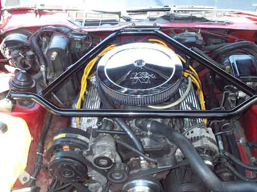

I got all the pipes out along with the condenser and compressor, now where can i go about getting the blower box to get the rest of the pipes out from the box.
I thought I read that the dealers stopped carrying them or something like that. So, I'm hoping some off the wall manufacture might have one laying around in the back of a warehouse or something. And, I thought someone fabricated one from a S10 awhile back.
I got the pulley now I just want to do something with the ugly part of my firewall like you see here ......

Yah, they are hard to find. Last year one was GIVEN to me of all things, and I found one at a junkyard for $50. Talk about luck. Anyway, I used one, and the other I gave to a friend. Here's a pic of mine installed.
