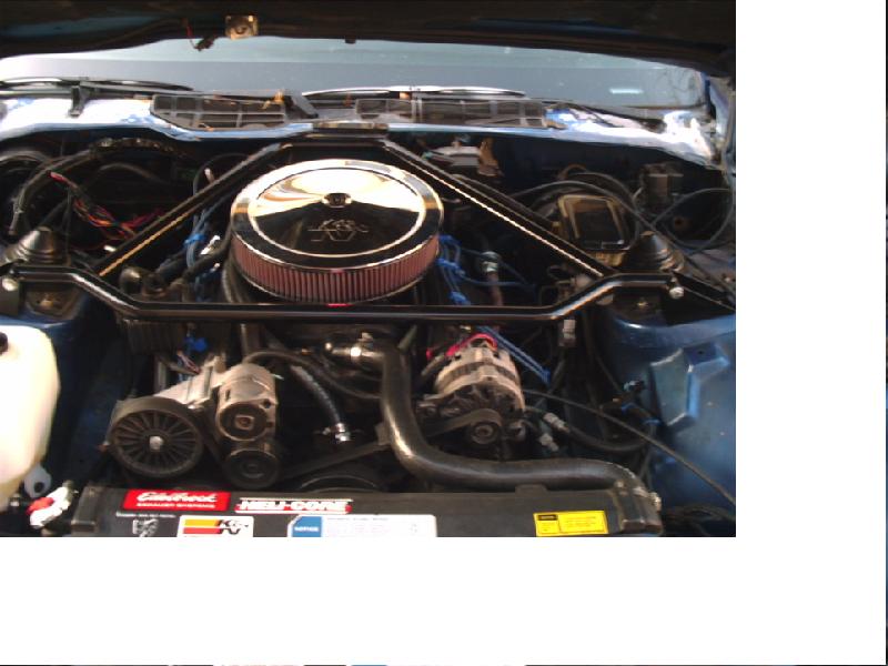

10055890 is the part number for the AC delete pulley and go to http://members.aol.com/iroczdave/pubpage.html and get the non AC heater box to cover that hole. With the AC delete pulley you should still be able to use the tensioner.
here is a pic of mine
Attached Thumbnails 2 A/C questions-enginepic1.jpg
Old Jun 3, 2002 | 01:18 AM
89WS-6's Avatar
Posts: 439
From: Houston, Tx.
That's a nice looking engine compartment man, so you removed your smog and A/C and just put this *does nothing* rotating thing with a belt tensioner on it and that did the trick? Just wondering what that was? Yeah man, thanks for the link, I now know what to look for, but I think I am just going to put a piece of sheet metal over it. In all honesty, that guy on that website is the BIGGEST rip-off I have ever seen. EVERY part he has on there are like at least 10 times more than a junkyard in the same condition. But anyway, get back to me on that belt situation, I'd appreciate it. later,
