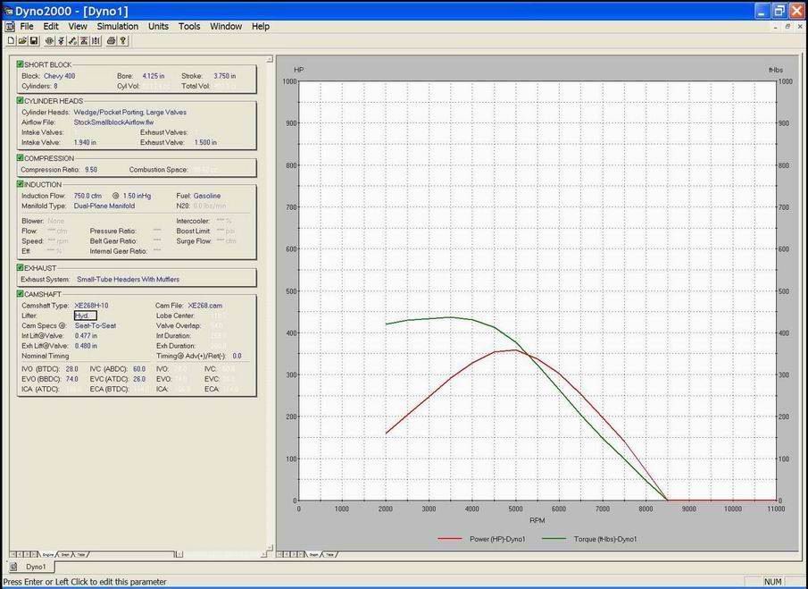

OK, here it is. I could only use the info you supplied. If you were more specific about the heads, that would help a lot. But this will give you a good idea of what you are looking at
It's gonna be a real torque monster! And a rocket ride with the HP coming on like gang-busters as the rpms increase
If you are using some nice heads, like Vortecs, that will have your 406 pushing a good solid 400 hp--you gotta like that :hail: :hail: :hail:
You should be pulling at least low 13s in the Quarter, once this is setup properly. I think 12s are almost a certainty, too. :rockon: :rockon:

Alright, thanks for the Wedge Heads tip! I changed them over to Stock type, though it doesn't seem to have made much difference. When I choose the Stock Smallblock Air Flow profile, it changes the cylinder head type back to Wedge. Go figure. Anyway, voila!
I also upped the compression to 9.5:1 to better reflect the 64 cc combustion chambers. It is about the same as the other chart. Add some nice Vortec heads and you'll be right on to 400 hp

And here's the torque and hp tables. This engine should be the equal to an LS1.

Well, the loss of hp from compression is not huge, maybe 10 or 15 hp or thereabouts.
F-Bird'88 is one of THE smartest guys on the whole board, though, so anything he advises is well worth considering
Especially the head port/polish work

Desktop Dyno 2000 is usually within 5% of actual power. You are right in the ballpark with your estimate. Vortec heads will really put you as close to 400 hp as possible, with civil street manners, too
It is that nice fat, flat torque curve that you are going to like the most :hail: :hail: :hail:
