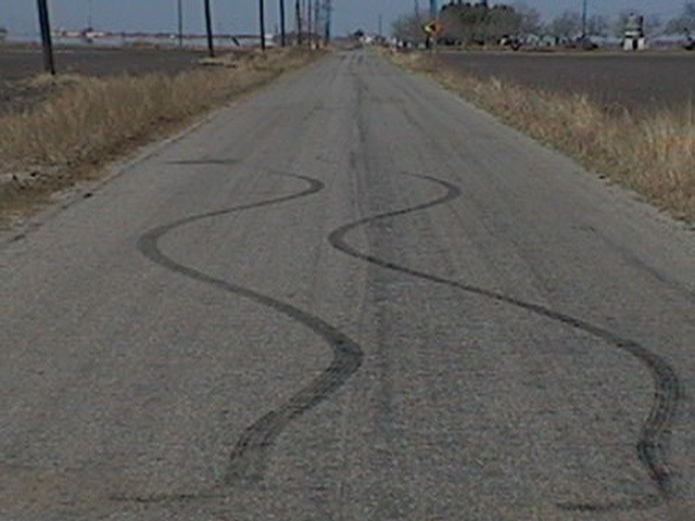

one wheel spinning....hmmmmmmmmm that sux
you need posi

looks as if someones got a one-wheeler peeler...but we have proof that at least SOMEONE on this thread has posi!!!! lol broady

Or did two identical peg-legged burn-outs.....

:nono:
you need posi
That looks just like a "Slippery When Wet" sign.
