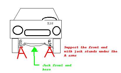

If anyone has pictures of a front end on jacks, that would be nice.
But for clarification, to jack the front end. I do it all at once, jacking from the main cross member under the engine, while two jacks stands hold it up at the a arms(which ones are the a-arms?)?

Here ya go....
Old Dec 23, 2003 | 02:23 PM
F-BIRD'88's Avatar
Joined: Sep 2001
Posts: 6,111
Likes: 53
From: Ontario, Canada
Car: 1988 Firebird S/E
Engine: 406Ci Vortec SBC

Man that is exactly what I needed.
Thanks alot
BTW, I love the little z28 you put in the drawing

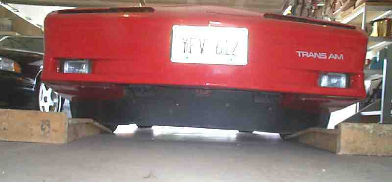

Or, you can:

Vader, that looks like a great idea!
Now, as for the factory scissors jack, you know, for an emergency, where are the front jack points for that? I can easily tell where the rear ones are, but I don't see any for the front.

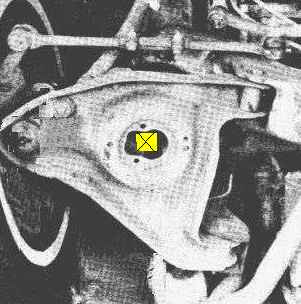

I would say it depends on what your doing and the kind of jack you have. I have just a small floor jack and jacking on the K member will not even get the wheels off the ground.
In the front I tend to jack on the A-arm. Jack head fits nice into
the "shock" hole and gets the tire off the ground much easier. There is just so much travel in the front end you gotta have a big floor jack to get the front end up high enough to use stands.
