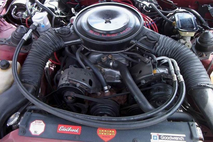

I couldn't get the driver side duct either, so what I did to enlarge the duct's outside diameter at the connection to the flexible hose was to wrap it with black electrical tape until it was a snug fit. Works great and looks stock, unlike your white taping job

See?

Yeah my duct tape job was pretty lame but it was all I had at the time and somebody was asking me for pics. I wold like to try to find something that will make a better fit. Have not been successful yet.

Wrap electrical tape around the end of the plastic snorkle until the duct slips over it snugly.

I see what your saying now. I can't even tell that was done on your car. That's a pretty good job. I will try it. Thanks!!

Yup
Can't even tell it's not stock
In fact, the differences between the LG4 snorkle and a proper L69 snorkle are miniscule. The openings are just a tiny bit larger at both ends, but you'd never know it to see the LG4 snorkle properly modded with about 20 wraps of electrical tape
Post a pic when you are done so we can all behold your flawless workmanship
