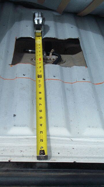

I cut mine out. And yes I ended up cutting the steel lines also. It was not the easiest thing I have ever done for sure. I was very concerned with cutting the fuel pipes cleanly and it was a pain. Really the high pressure fuel delivery line is the one that is probably most important to cut cleanly. I used high pressure hose to patch it together when I put it back it. I used tin snips to cut the hole in the body and it is not the cleanest hole in the world. You have to cover that hole with something if you do this. Exhaust fumes seam to really like to migrate there. The carpet will not do it. Make sure you use something to get a good seal <-(spelling).
Do I think this is the best way to do it? NO. Did it really make it easy when I replaced it with a pick-up tube a few weeks ago? Yes.
You know this post got me thinking. Maybe if I had cut the hole differently I could have just loosened the steel lines where you normally would when pulling the tank and pulled the whole thing out without cutting
. Oh well, just don't do something you think you may regret.

i reciently replaced the pump in my 89 firebird. i cut the area above the tank and was able to remove the entire pump assembly intact without cutting the fuel lines. it took a little finesse and a little bigger hole but it did come out. loosen the tank straps and remove the gas fill door assembly loosen fittings on fuel lines and work with the pump assembly (be patient) if you can find someone to help with the removal, is easier with 2 people. one in back of car and one under car.good luck let us know how it goes .

Mine was cut open by the previous owner.
I had to go in there to repair the fuel guage sending unit.
A real time saver. GM should have made an access hatch
in the floor in the first place.
I'd use a circular saw with a metal cut off blade.
Just adjust the depth of cut to just cut into the sheet metal
so you don't hit the tank or lines.
Cut a rectangular shaped door (3 side cut) so you can fold down the flap of steel when you are done.
You can fill the thin gap left after with automotive seam seal.

I agree with F-BIRD'88 on this one. GM should have done this from the factory. I had to replace a pump on a friends 85 TPI on a lift at work and it seemed pretty easy. Until you try to remove the tank - that fuel filler neck is a real PITA!! - even on a lift!
If I had to replace another one I'd cut "The Hole" and either do it flap style like F-BIRD'88 or cut a round hole and I'd place a large rubber grommet in there like most new cars.
You call it a hack job, I call it intelligent re-engineering. Just because GM designed it that way doesn't mean it's the best and only way. We all end up modifying our cars and "clearancing" to fit hi-po parts, why not a fuel pump?
Next time you need a pump, you won't say, "Oh $hit, I've gotta pull up that flap again and spend 30 minutes changing the pump!". However, you'll be cussing up a storm next time you remove that tank.

The panel is sealed and is covered by the rear carpeting and everything anyway, out of sight and out of mind, so... :: shrug ::
I did a good enough job so that fumes won't enter the cab (the sheet metal on my "access panel" is bigger than the whole and sits on top of it and is sealed.) Call it the slacker's way out and what have you, but cutting the hole and all that is still work, it isn't being lazy just because it's an easier method, it's just common sense. To those who did it the "right" way, good for you and that's cool that you did. But I'm just saying I'd have no problem doing it again. I do wish I would have cut the fuel lines at different lengths though, would've made re-connecting and clamping them much easier.

Here ya go...i found this pic of a fuel pump swap...I dont think taking the axel all the way out is necessary...but if you cant get it way off the ground it might have to be done. Just something I found.
