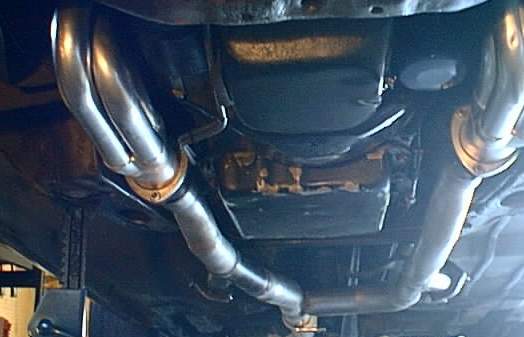

I would get rid of the shorty headers (some one will buy them)and get long tubes and build your own Y pipe. You can still connect this into a 3"+ catback type exhaust.

Here is a pic of the exhaust.
