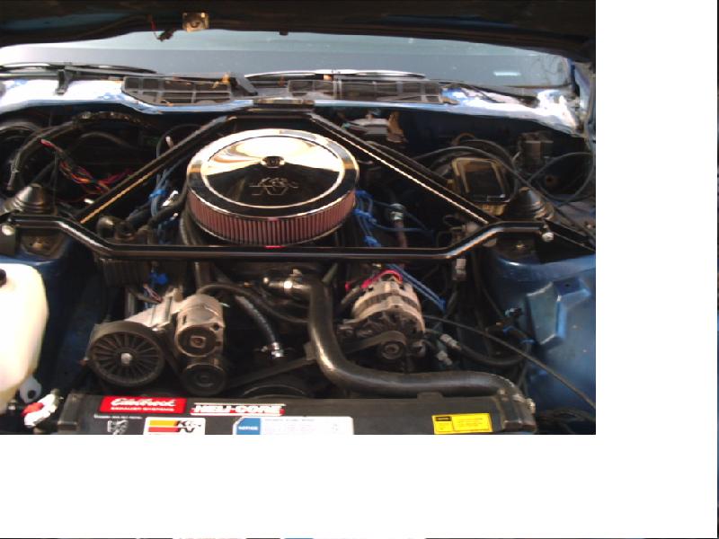

if u want to do it right, use part 10055890 (AC delete pulley) and find a non AC heater box (got my from IROCZDAVE)

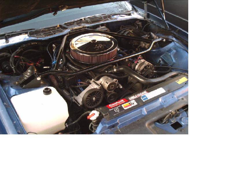

another angle

Well for one, the A/C isnt robbing horsepower unless the system is turned on and the compressor is on. Other than that, it spins freely but the whoel thing adds weight and clutters the engine bay. Thats why i took mine out.
you can start off by undoing the metal lines that run from the airbox to the condenser. (the condenser is in front of the radiator).
When you loosen the pipes, the frio is gonna go all out into the air and the EPA will be very upset. They are gonna be a pain to loosen and some you might not get at all to be honest. Best bet is to use 2 wrenches.
Unbolt the 4 radiator bolts on the top, this includes the 4 bolts on the fan and tilt it back. The condeser will be able to come out. Theres 2 rubber pads that the radiator sits on, so be sure to put those back on.
then the silver canister can come out, and the tricky part that got me was i was trying to loosen the nut thats welded onto it .... duh.
where your at now is where you need to order the other parts. The pulley that replaces the compressor like vjo90RS8 said.
Then the non ac heater box which is hard to find. I dont know if iroczdave has anymore left. you can try him. IF you do get one, then all you do is remove the bolts holding it on, (some are inside the car too against the firewall) and put the new one on. A couple bolts wont line up anymore.
Thats all i can think of here at 2:30 in the morning. If your confused you can PM or e-mail me. hope that helps a bit.
~Tim
