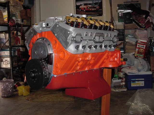

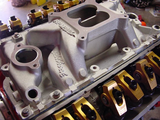

A pic or two for anyone who's interested. these were obviously prior to getting rid of the crane rockers and prior to dropping in the car. I'll try to get some updated ones in the car.. Does anyone care being that it's not a thirdgen? someone let me know if it's of any use to anyone.
