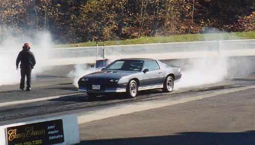

Getting close to 12's
Finished the year OK but slightly shy
of very low 13's goal. Last and best run:
2.084
5.668
8.642 @ 82.26
11.211
13.373 @ 104.07
Above run was against a friends 2001 Corvette and went neck and neck with
him winning by 0.092 secs. Lots of fun !
My question to the forum is what are
the next mods to reduce ET by .38 secs.
I am thinking exhaust cutout and lower
pressure in the DRs since I run them
way too high at 24 psi.

You're close! Like was suggested before- you've got 2 of those 3 tenths on the launch. I can crack a high 2.0 on street tires in my Malibu and that thing doesn't hook worth a crap. With your upgraded LCA's you should be able to pull a low 1.9. If you find that difficult and have checked everything else then try a set of weld-in subframe connectors. They do wonders for the launch on 3rd and 4th gen cars. You wouldn't think they'd do much but they make a noticable difference. My brother's 87 GTA laid down a 1.92 60-foot time on street radials (Firehawk SZ-50s???) with better LCAs and subframe connectors.
Say, that reminds me. Another great traction mod is LCA relocation brackets. They alter the rear suspension geometry slightly so that the tires get shoved toward the ground during a hard launch, instead of the neutral, possibly negative behavior of the stock suspension geometry, which was never really made for dragstrip launches.
BTW- in that burnout picture I can't tell if the diver's side tire is spinning or not. Is that just smoke from the right side making it's way left? I see smoke behind the tire but not coming out of the wheelwell around the tire, like one would expect. You sure of the condition of your old Posi?

Wow, thats what I like about this forum,
sharp people! I was wondering if anyone
would pick up the tire smoke only coming from the pass side. The original posi is
tired and the Zexel Torsen is in the basement. I have got most suggestions
covered, no swaybar, relocation brackets, modified vacuum canister. I have really followed Damons Qjet knowledge and the carb runs great. One
exception is CE rods. I guess I will look more closely at sub frames and an exhaust cutout.
Thanks again guys........
