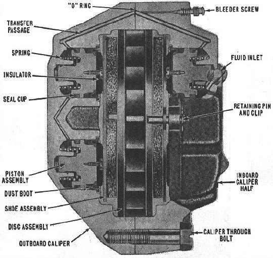

The reason I'm concerned about the ability to pump up the brakes is that it is possible you have caliper issues. I understand that one was replaced, but there are three remaining. If one of them has a broken, weak, or incorreectly installed piston spring (even the replacement one), you might have a caliper backing off while the car is sitting idle. Until the fluid is pumped back into the caliper, there would be excessive pedal travel. I'm basing all this on the fact that you car should have the older four piston Delco Moraine calipers at all four wheels.
Attached Thumbnails 4 shops, 9 tries, several grand later and still cant stop (non thirdgen)-corvettedm4piston.jpg

The reason I mentioned the replaced caliper is that I have received remanufactured parts that were incorrectly reassembled in the past. Everyone has a bad day now and again, even the rebuilders.
Not out of the realm of acceptable diagnostic procedures would be the possibility of capping or plugging the brake lines at either the front or rear end of the proportioning valve to help isolate the problem. The same could be done at each caliper to isolate it further.

No, no amount of pumping gets the brakes back to as they should be. While the last shop was working on it they did have that kinda situation where the first 3-4 pumps would floor but it would be fine after that. That was before they replaced the booster and it worked for them fine after that.
Interesting point bout the calipers Vader, we will definately try and cap off each one at a time and see what happens.
