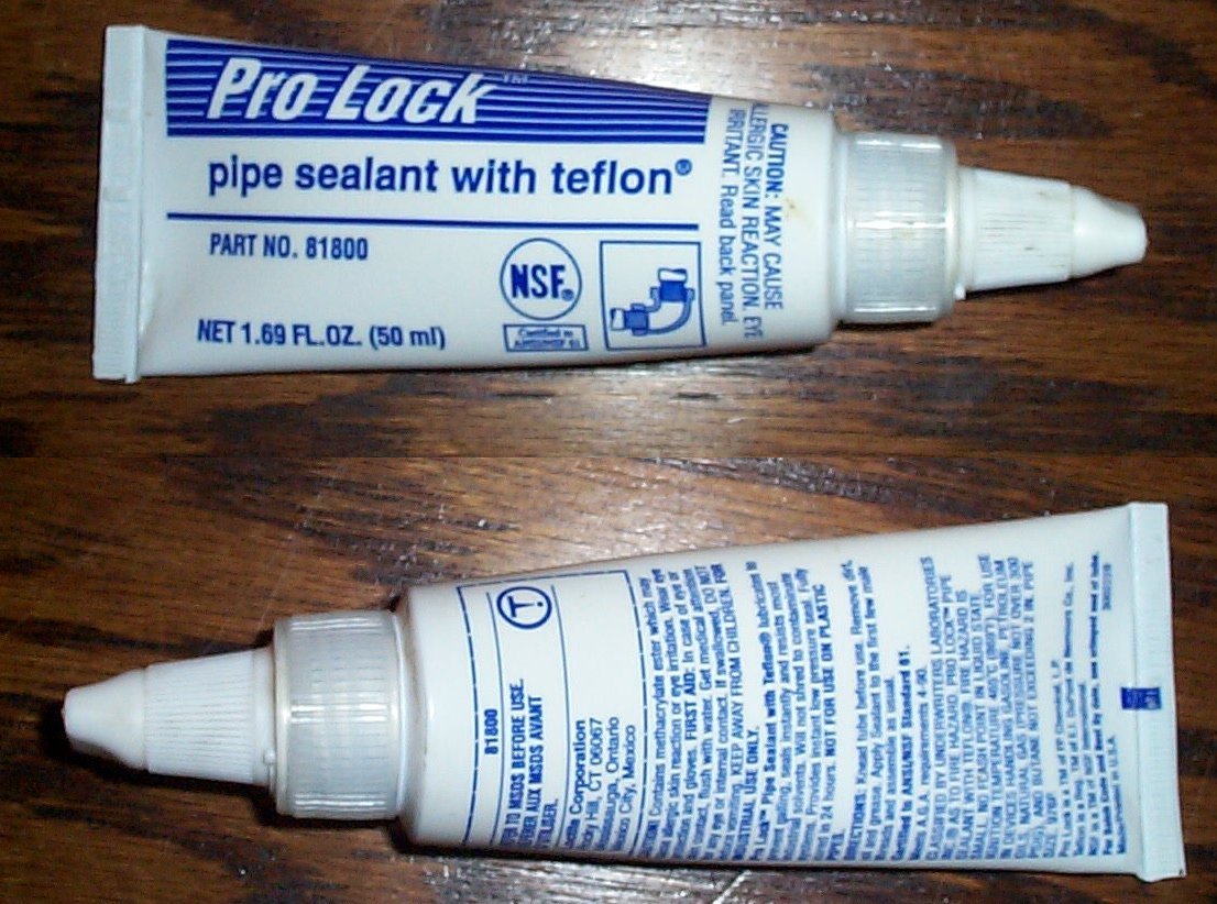

Does the liquid teflon stuff harden up? Or is that the same as the ARP white stuff.
Trending Topics
Later,
Vader
All my life I've been searching for something. Something never comes - never leads to
nothing...

vader -
does that stuff harden? bort mentioned that it may not. I have already used the ARP thread sealer (white gunky stuff) and it did not harden and it did not work. I suppose I could yank it all apart and use a lot more, but it seems like engine vacuum will just suck it on through just like it's doing with the oil. grr.

Dunno about the stuff Vader posted or the ARP stuff, but the GM stuff is an anaerobic style sealant and hardens in the absence of oxygen.... So the stuff you can see will still be tacky forever but the stuff sealing the threads will harden. But it doesn't really turn into a rock either.... The bottom line is that I used the GM stuff on my TFS heads (as well as countless other applications when I was a tech) and in that exact application for the rocker studs when I put the engine together and it uses virtually 0 oil and never emits any smoke. How certain are you that your oil consumption issues are from the rocker studs?
