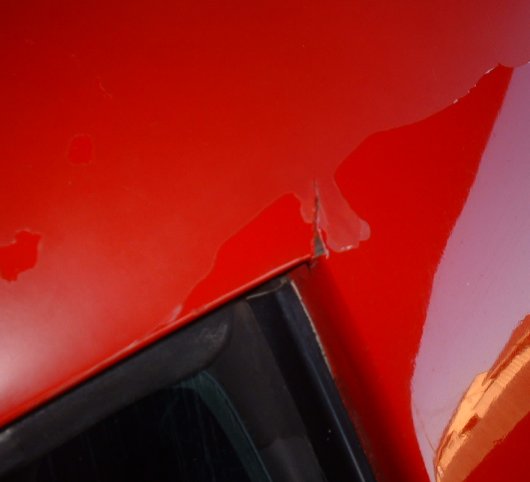

Have someone post the pic of the stress cracks that appear around the back corner of the side glass that are caused from too much flexing. I'd perfer rearanging the crystilyne structure in a small area of my frame as opposed to a big crack on top of my car. Oh well just my 2 cents, hopefully somone knows the type pic I'm talking about.
David
you mean these??
Attached Thumbnails URGENT QUESTION: about welding in general, and sfcs...-crack.jpg

That's them!
