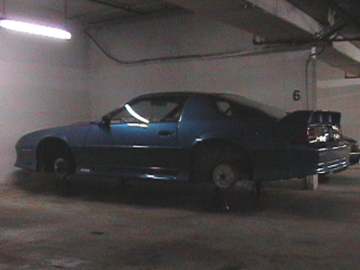

I put my car on jackstands. I asked around and everybody told me it was safe. I put the stands on the suspension, not the subframe. I have SFCs too if that matters.
Anyhow, front ones are on the control arms, and back ones are also on the lower control arms because i couldn't get it on the axle (sway bar was in the way). Anyhow people are telling me on the board that it will ruin my unibody...
I think they're all wrong and I have a million people backing me up. Take a look, what do you think?

Personally I would have the stands under the front a-arms and under the rear axle. That way the suspension doesn't hang down. There no way it would hurt the car because the car would still be supported by the suspension.
It sounds like you have it as best as possible because of the rear sway bar. As long as the rear stands are as close to the axle as possible it shouldn't hurt the LCA. Either way, the car body is still being supported by the factory suspension. Just make sure the stands are the same height at the front and the same height at the rear. That way there's no side to side height difference. Do a quick measurement to the top of the wheel well to the floor. If it's sitting square side to side then the car will be fine.

I hope you have some super strong aftermarket rear control arms. One late night I bent the hell out of mine thinking I could put a jack stand under it. Gave myself one more reason to get a pair of lakewoods. In the future i would never support any car by the rear lower control arms. Bending them could change your rear alignment, and if you're using factory ones, they are weak enough as it is, they cant handle the slightest dent, bend, or anything else. Just been my experience, I dont mean to be the profit of doom.

Easy....the guy has a good point about the rear LCA's. On a rear end I recently picked up with the LCA's still attached one was all bent to crap, I suspect from a jackstand. Anyways not a big deal or anything since I wasnt planning on using them anyways.
Regardless if you do find that you do end up bending one of yours this year, dont sweat it, I will have an extra set you can have next year once i swap in my new rear end and the lakewoods LCA's I picked up last weekend.

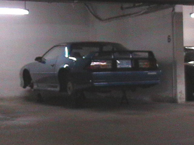

Jackstands in a parking garage! You are a brave soul. Hope no stupid person hits it and knocks it off!!!
I regularly put jackstands under my Lakewood LCA's with no problems or damage.

lol let me ellaborate on the underground garage. It's underneath an apartment building by my house. To get in the apartment building you have to be a home-owner in the neighborhood and buy a special laser-cut security key from them. These keys cannot be duplicated. They charge $50 per key and keep a list of who buys one.
There is a camera on every entrance to the apartment building. In the building itself there are cameras everywhere, in the elevators, in the basement halls, and in every row of the underground parking garage, including the entrances. Heck a friend of mine who parks his bike there leaves his bike jacket and helmet just on the bike.
On top of that there are security guards patrolling all the time. They all know my car, they love it, and they keep their eye out for it. You should see, whenever I go to my car and pop the hood, literally 20 seconds later there are 2 guards downstairs about to beat me with a club... they see everything on camera hehe.
BTW, you can't tip my car over no matter how hard you tried. I put it on the jacks very securely. :hail:

Ah, don't listen to them [the people telling you that's wrong]. They don't know what they're talking about. Storing it with a loaded suspension is the same as the way the car sits any other time in it's life, you're just protecting the tires, that's all. That's the right way to do it.
I think the control arms are okay to use, but only if it's absolutely the only place you can place the stands, and then I'd use a short 2x4 to spread the load over the whole arm.
