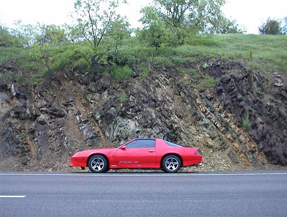

Old Nov 26, 2002 | 08:16 PM
Mark A Shields's Avatar
Posts: 7,164
Car: 99 Formula
Axle/Gears: 342
you can see mine hangin down in this pic, towards the front end.

Old Nov 26, 2002 | 09:40 PM
Dolph88sc350TPI's Avatar
Posts: 148
From: Moss Pont, MS
Car: 88 Camaro SC, 86 T/A, 92 Eclipse
thanks, it's definitely not there anymore
