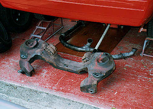

Further conclusive proof!! And you would be surprised to know that it can be picked up very easily by one hand. Surprisingly light.
Andy.

Old Dec 7, 2002 | 04:16 PM
Andy Fanshawe's Avatar
Joined: Oct 1999
Posts: 796
From: Derbyshire, United Kingdom
Car: 91 camaro rs
All agreed then-don't drop it!!

Seriously, Don't remove the K-member to change the oil Pan. You will be better off Pulling the engine.
