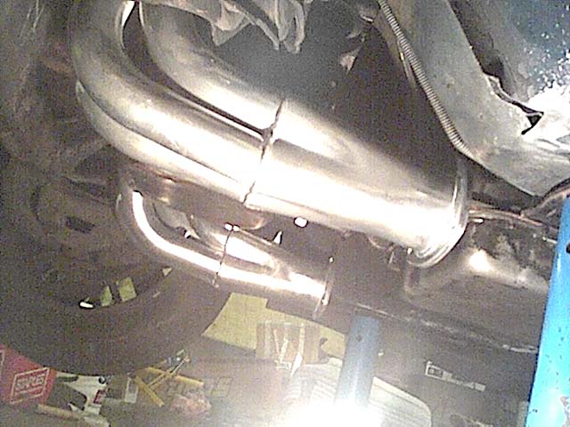

Conservitive how(timing)? I set it at 8. Do you have any suggestions. I didnt hear any detonation. It was running through open headers. One header has an extension on it with the oxygen sensor in it. Need to change it for a heated o2 sensor sometime soon but I am on a limited budget currently.

pic a week or 2 ago
