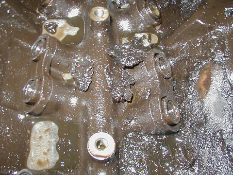

I recently bought an '86 Z28 that was in a complete state of disrepair for $1100. Upon removing the intake manifold during the tear down process we found perhaps the best reason to change your oil on time, take a look.
Giant rocks of hardened oil sludge in the lifter valley, yuck.

Old Dec 12, 2002 | 05:53 PM
joshp14's Avatar
Joined: Sep 2002
Posts: 1,834
From: Norwalk, Iowa
yummy, that looks good, looks like regurgitated diahhrea

My ole LG4 looked worse than that, specially in the heads area. I should have put it in cups when I cleaned it out to measure.
No wonder the new cam I had put in it, ruined the motor.

looks more like the egr ports were leaking in there

How can ya tell?

I doubt it. That stuff will coke just from the heated metal of the cross-over passage. Especially store-brand, 10W40 oil (or Pennzoil... )
If you look under the intake heat shield, you'll get another picture's-worth-a-thousand-words.
What it really is, is motivation to use AMSOIL. You'll get that stuff with petroleum oils (especially those with a lot of VI improvers, like 10W40's), even with the recommended oil changes.

when the exhaust leaks in up there it tends to leave deposits in the oil and kinda bakes it in there. also bad rings do that too!

five7kid: under the heat shield as in, once you take it off the manifold? the part inside?

That's nasty. My 305 looked kind of like that after 14 years of regular oil, but not nearly so bad.
You should drain the coolant from your intake before you pull it so it doesn't end up in the oil.
