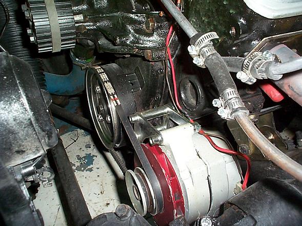

Well as long as you don't have huge tires on the front, then I would remove it all and get a aftermarket bracket for the alternator. The L98 in my Monte SS only has the alternator off the crank pulley I have a Mr Gasket electric motor running my water pump work great.. Don't mind the coolant everywhere..I blew the rad.
Attached Thumbnails possible to remove the pass. side engine Acc. bracket?-picture-401small.jpg
